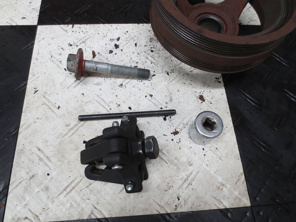

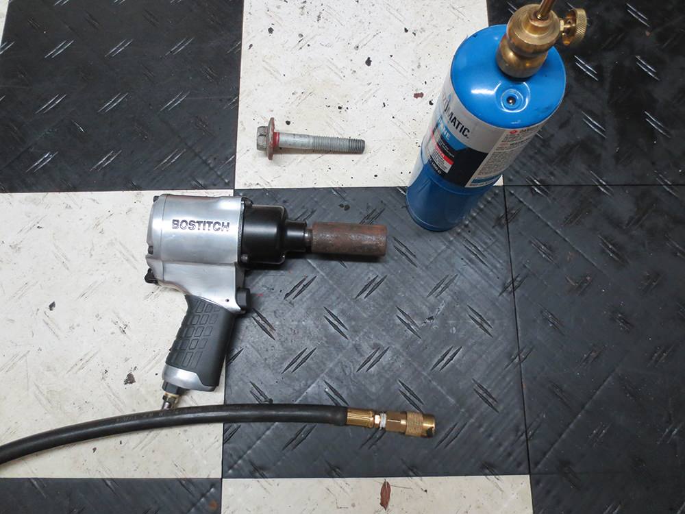

Just buy a cheap torch from Lowes or Home Depot. Used a torch and impact to remove mine. Then used an Autozone free rental (Chrysler type) balancer tool.
