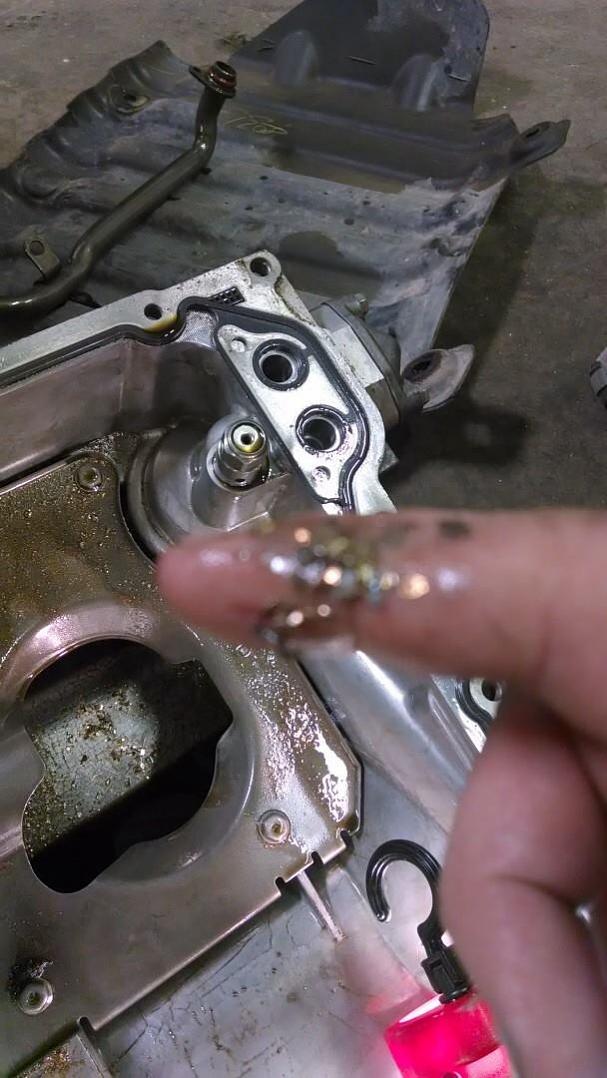

Chicken and the egg.... What happened first did the bearings go out and cause the oil pickup to clog or did low oil pressure destroy my bearings. Happened today on the dyno less than 300 miles on new engine

What bearings went out?
Was the thrust bearing set right?
What was the oil psi from the 1st start up all the way till the 300 mile mark?
Did you prime the system before you cranked it for the 1st time?

Damn thats a lot of material. What does the oil pick up look like? Did you cut the filter yet?
