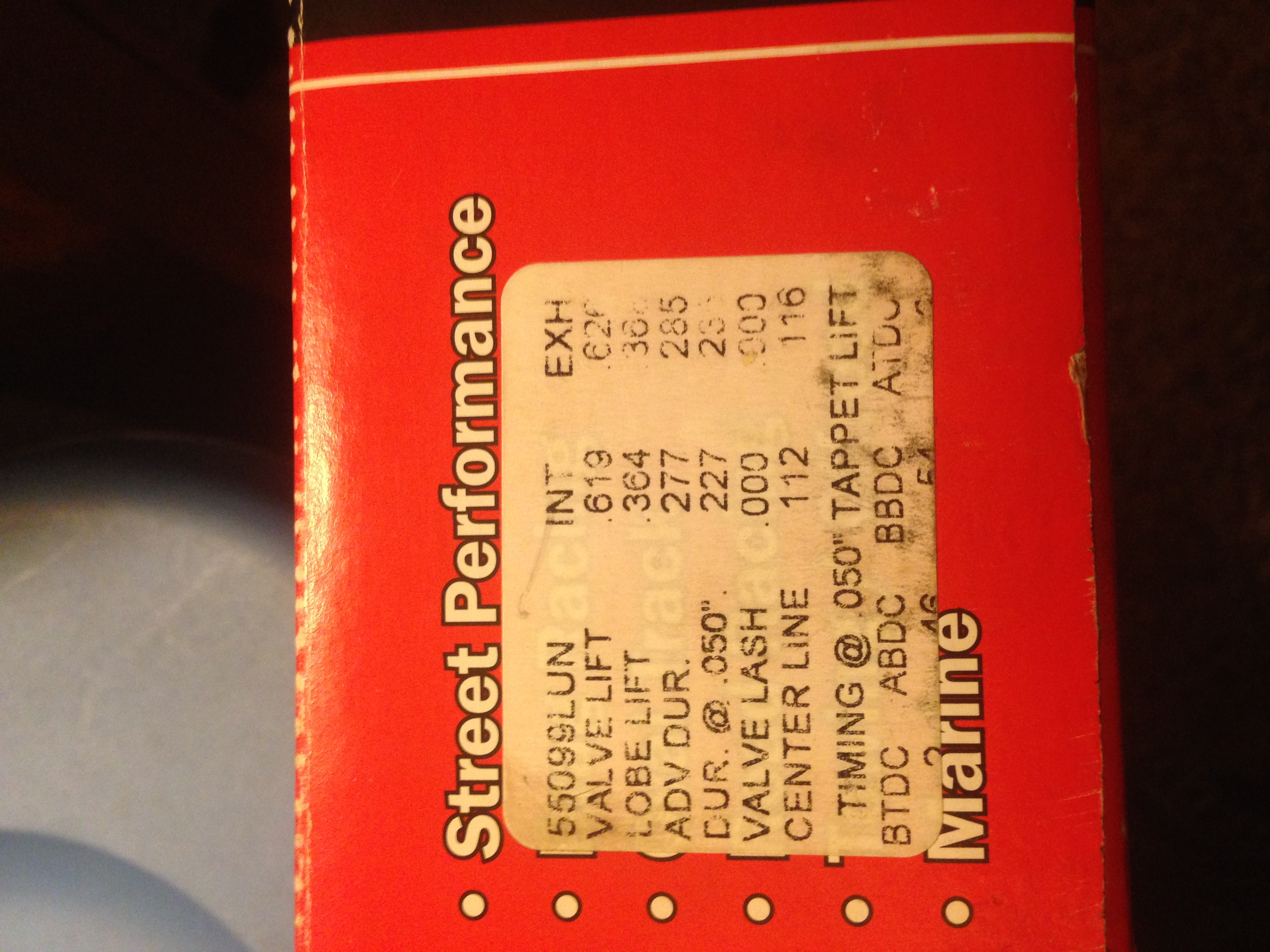

Just curios as to what what everyone thinks about my mY cam choice for my build. I have a lq9 with a set of ported 317s that flow around 320cfm. A tbss intake and 92 mm throttle body, and 1 7/8" headers. I'm running a manual Trans and 3.73s. I bought a used lunati from a friend I posted a pic of the specs of the cam. Please let me know your thoughts as if I need a different cam the time to know is now. Thanks for the help everyone

Not necessarily ideal for the combo but it'll def be WAY better then stock. Heck I run a "crap" gm hot cam in mine and everyone said it wouldn't work..

Forgot to mention the heads are milled .030 to raise comp up to 11.0:1

Do you have a stall and bigger injectors?

Yes, I have some flex fuel injectors and I am running a manual trans.

Looks like a pretty decent cam for that combo. A buddy has a LQ4 with the carb intake, he used a TSP224 and 1 3/4" headers for his '86 SWB swap and the truck hauls ***.

That's good to hear. My engine builder seams to think it will do well in my combo.

Seems to me it's a fine cam for the combo.
