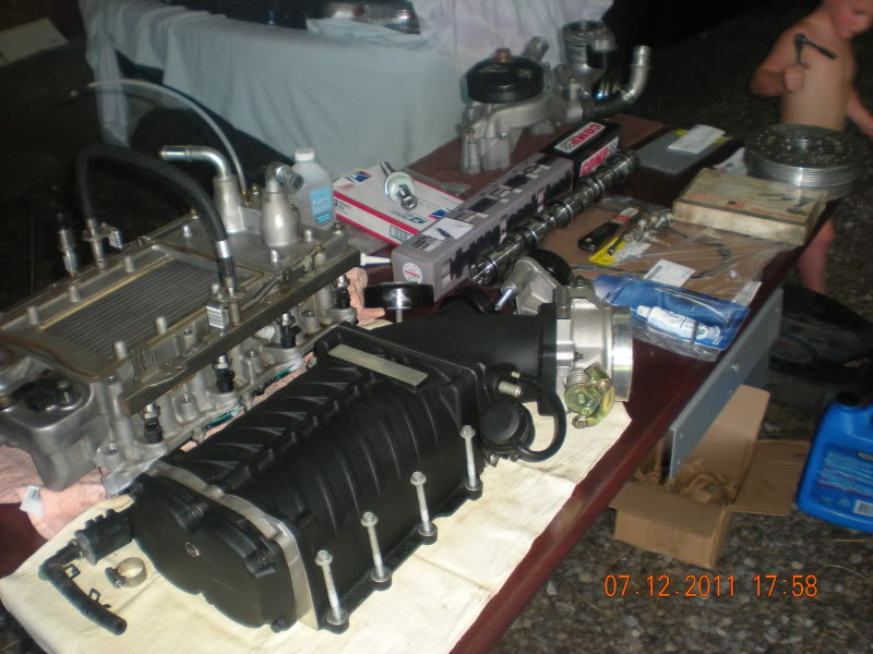

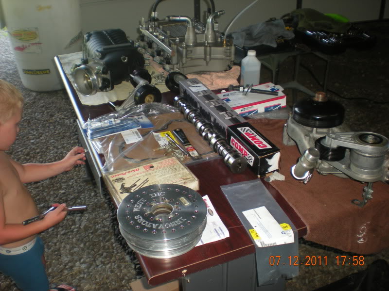

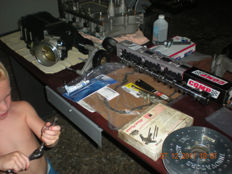

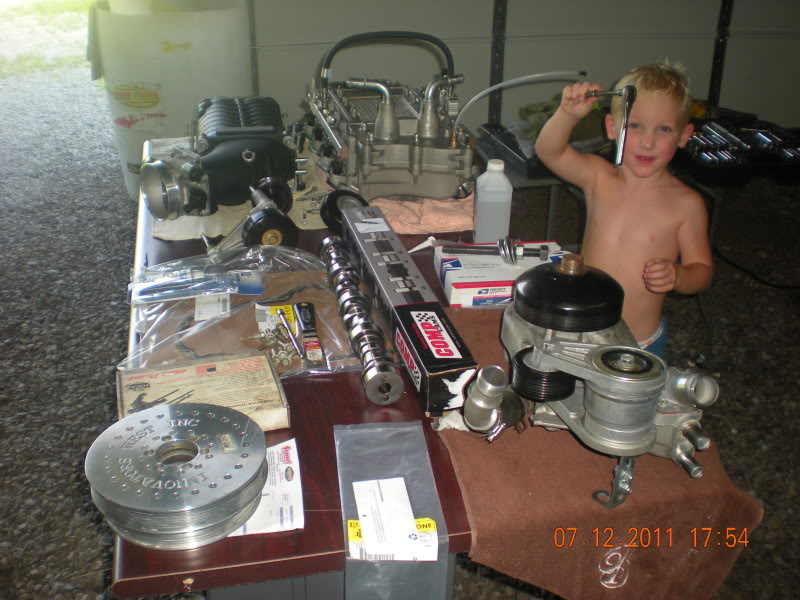

Heres My Helper( 3 yr old Wyatt) with my new parts that arrived, ( You'll appreciate this Billy, having yourself a special helper also.)

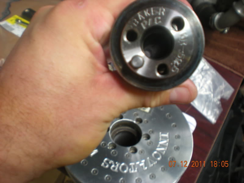

My Cam arrived today,( THANKS T J @ B.E.I.!) also Thanks to my bud 03sierraSLT For the crank balancer install tool! Ive used it before and it works great!
Also have my IW od pulley ready to install, im gonna do it all at once.

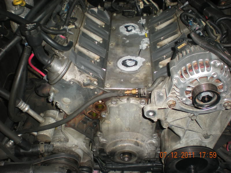

And a boring pic of the 6.0, i had to put a new knock sensor harness on, thats why i pulled the blower. She needs a lil clean up and paint while im there.
Prob wont be till this weekend i get it installed, then gotta see T J for a final retune!
I first saw the pics and I thought damn he pulled the supercharger off just to swap cams, must like extra work. lol
