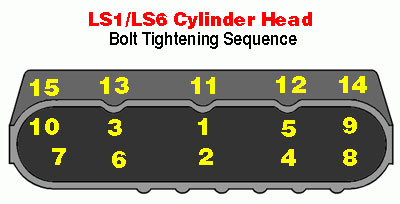

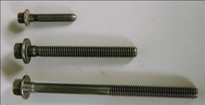

If #10 & 3 are the same length, then your stud kit will work. If one is longer than the other, then your stud kit will not work. The difference is the block, not the heads. Here's a pic of what I think you'll see.
