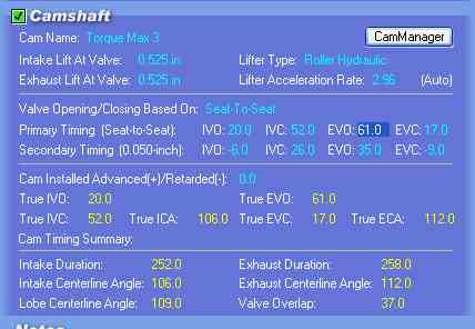

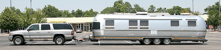

I have a special Comp Cam Grind Cam that works wonders for this. See Signature.
Steve

Comp just released 3 new grinds just for trucks, one is pretty much the same as mine (see sig), only on a 115 lsa. My cam is great for a daily driver, and I didn't lose anything down low. Check out Vinci's website also, they have a bunch of different truck cams to choose from.

I would highly recommend a small duration cam like the one that I am running 200/206. This cam has a lot of low end torque and runs out of breath above 5,000 RPM's. It does very well for my heavy truck and trailer. I'ts economical too.
Steve
