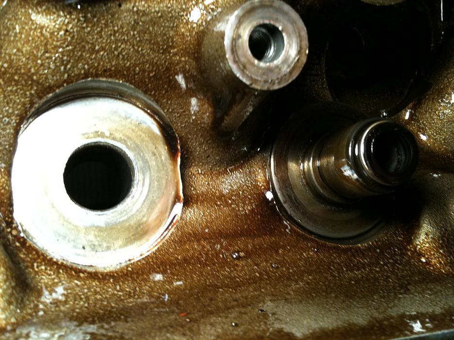

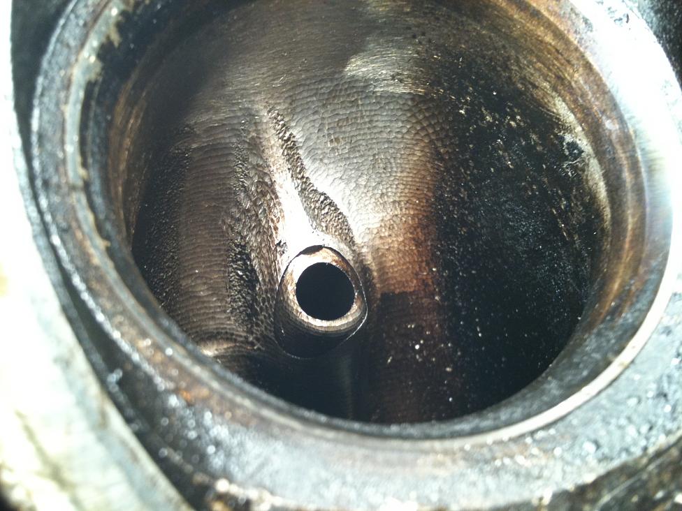

well I removed the head and found this. The guide completely came out of the head. one picture is of another intake guide that has started to move. The piston got hit a little but i think it should be fine. I think ill just replace the head instead of fixing it.
Attached Thumbnails 6.2 breaking valve springs-head1.jpg   6.2 breaking valve springs-head3.jpg   6.2 breaking valve springs-head4.jpg   6.2 breaking valve springs-head-2.jpg   6.2 breaking valve springs-valve.jpg

Who did the Extensive port work on those heads??? I wouldn't be suprised if the valve/ spring heights were not set up correctly. I also would not be surprised if the Valvetrain geometry was not correct.... I would have the other head inspected too... You might find and issue with the guides. If there loose and the valve is bounceing around it can cause other damage. Also inspect the rockers for excessive wear or possible deffects
