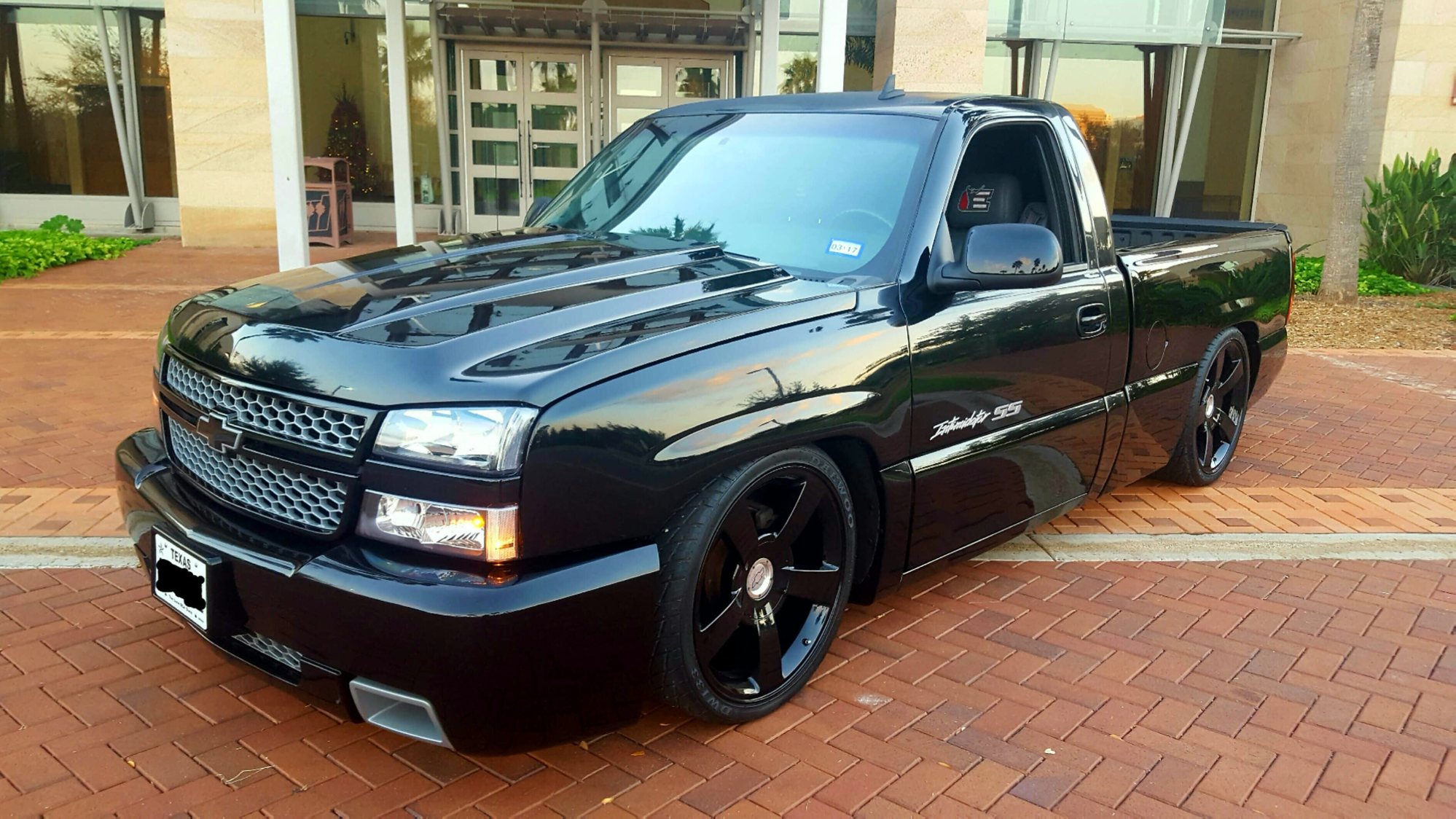

This is my truck is a 06 silverado with all oem parts from a Intimidator SS. I want to do the 6.0 4l80 and 14 bolt 9.5" 33 spline 6 lug axle with the D1 procharger not trying to brake any records just want a clean set up that will work all together. I don't want to bore/port my engine maybe just the 317 heads . Im planning on just rebuild the engine and paint the block gm orange or black get some ARP main studs and heads studs a Melling high volume oil pump, boost cam, double springs rockers lifters Pushrods.
Rebuild the tranny with a circle D 3600 stall and if I get the 14 bolt axel live the 373 . I will do the fuel upgrade when I get my procharger later on for know I just want to do the engine since I have it out and transmission.

Damn, that's a nice lookin truck you have there.

Yeah man. Beautiful truck. Where in Texas are you?

That's a really nice truck, looks almost too nice to drive. Should be a strong runner with your planned mods.
