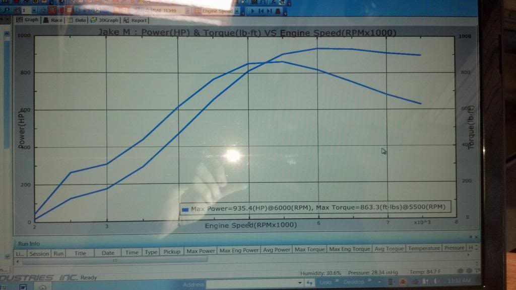

Originally Posted by Atomic
I wouldnt push it past 6500 or so
Psh, stock rod bolts.
