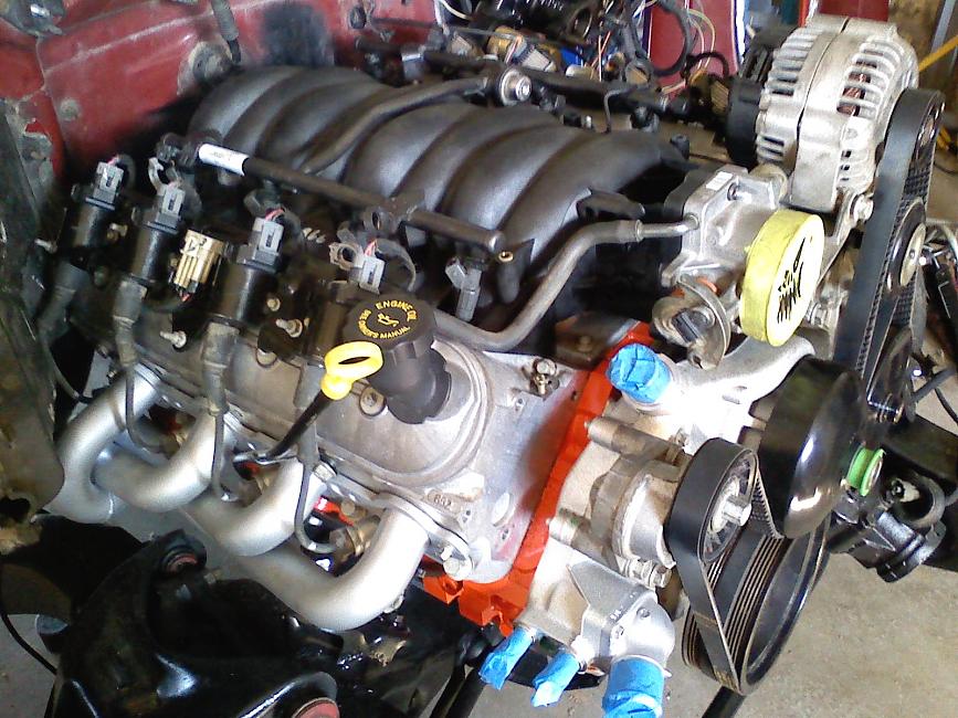

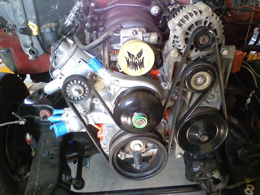

What Im working with.
Stock with Shortie headers and LS1 intake. Modified truck acces. And thats about it.
I know valve springs will need to be upgraded. Will this work with the stock lifters?
Thanks
Justin
