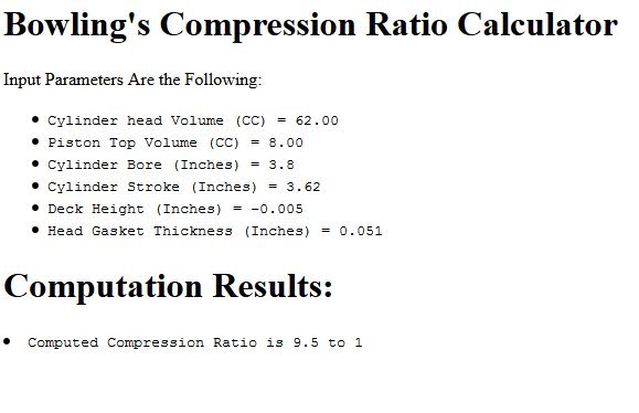

When I plug the stock numbers into the Summit compression calculator, it takes 8.8CC dish to get 9.51:1 compression.
I assume
pistons are 5 thousands above deck.
051 gasket
61.15 chamber volume
9CC dish
stock bore, stock stroke

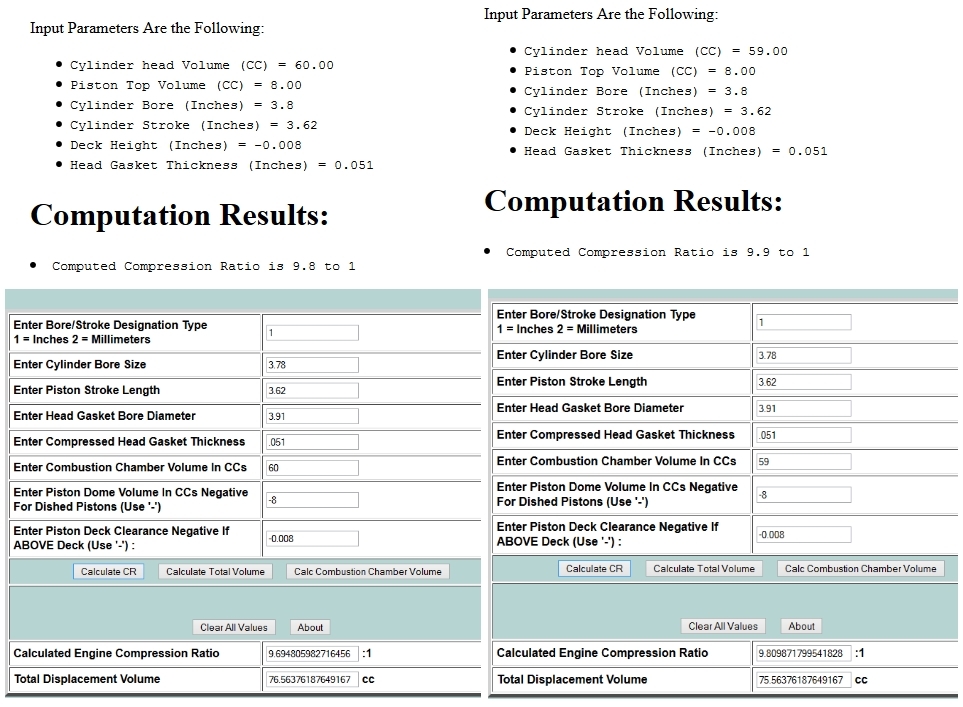

Old Jul 8, 2015 | 12:26 PM
bobfig's Avatar
Joined: Oct 2010
Posts: 363
From: Houston, TX
