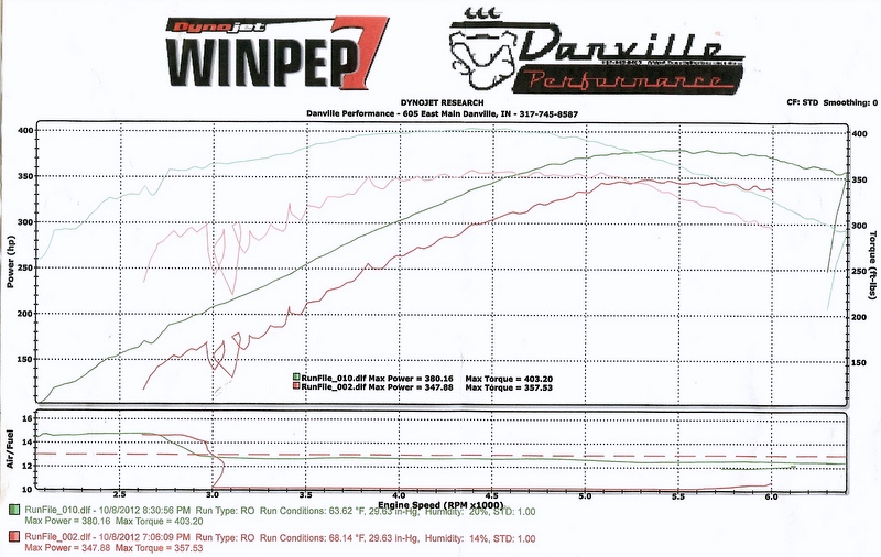

Yes went across Mount Eagle on 24 with open car trailer around 7800 lbs 75 mph cruise on and in overdrive never down shifted. I had it dyno tuned now I understand all dynos are different but 380hp 403 tq I will add the sheet hope this helps thanks. Red is before tune Green is after the tune !

Nice torque curve but a 6.0 is in a different league compared to a 5.3
Anyway, hard to beat a 210/218 or 212/218 for a DD 5.3 IMO

Do you happen to have any numbers from just the cam swap?

No sorry I don't I kinda wish I would have had the 5.3 tuned B4 to see the difference between them oh I'm vey happy with what I have Thanks
