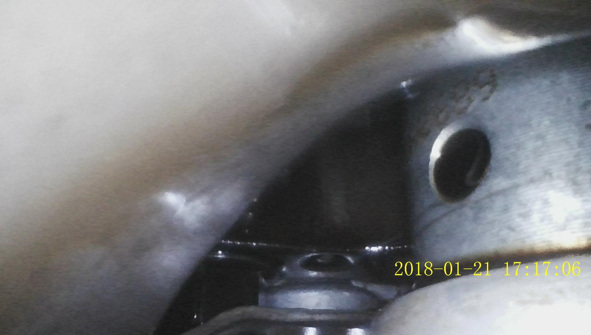

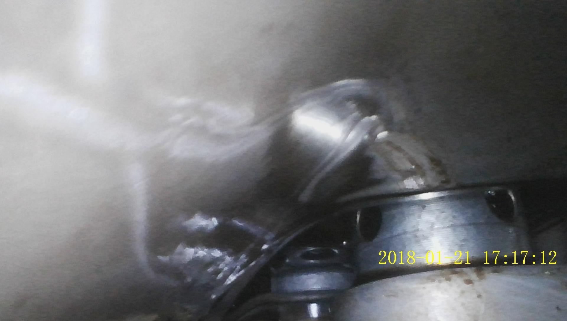

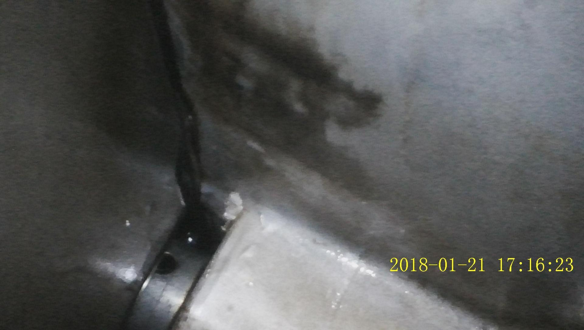

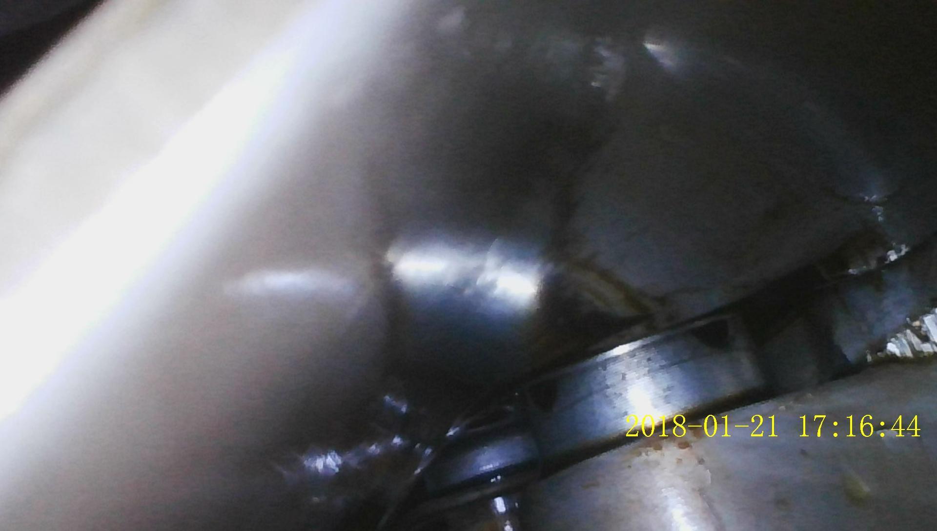

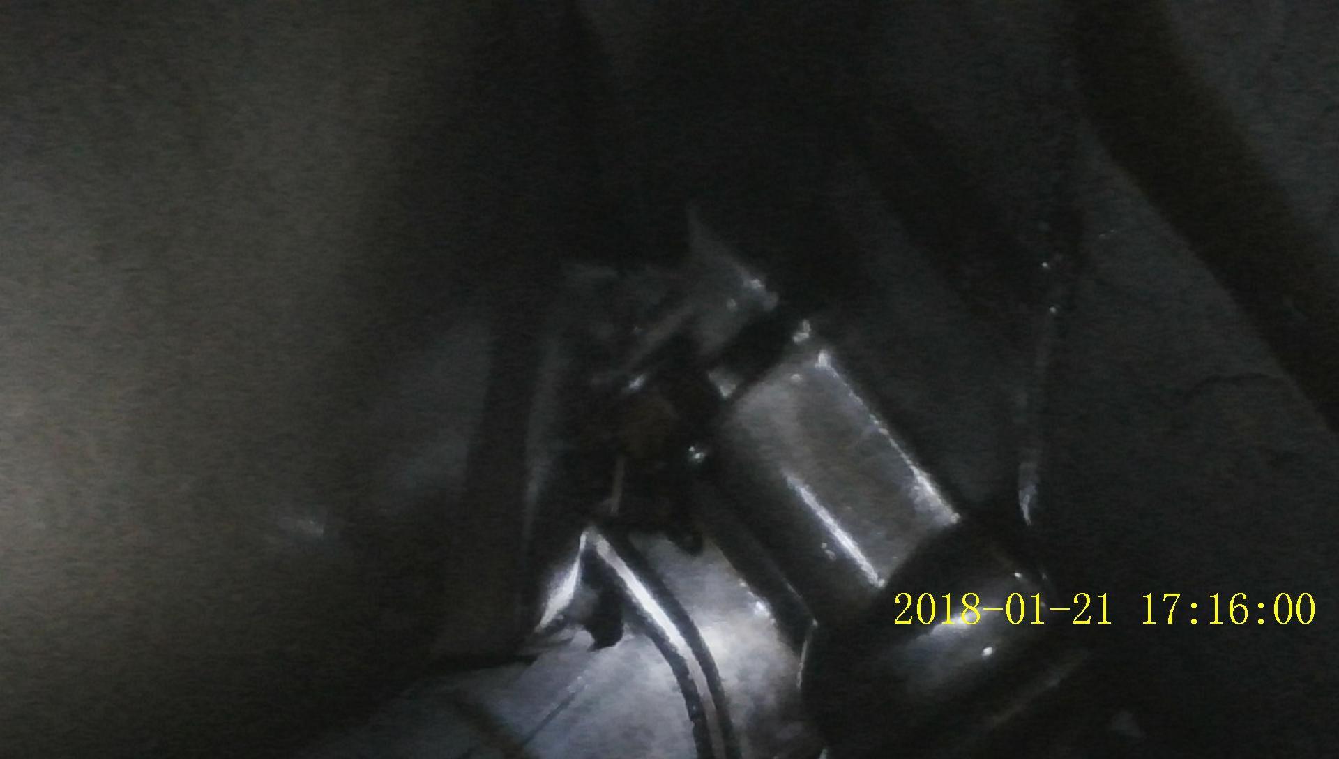

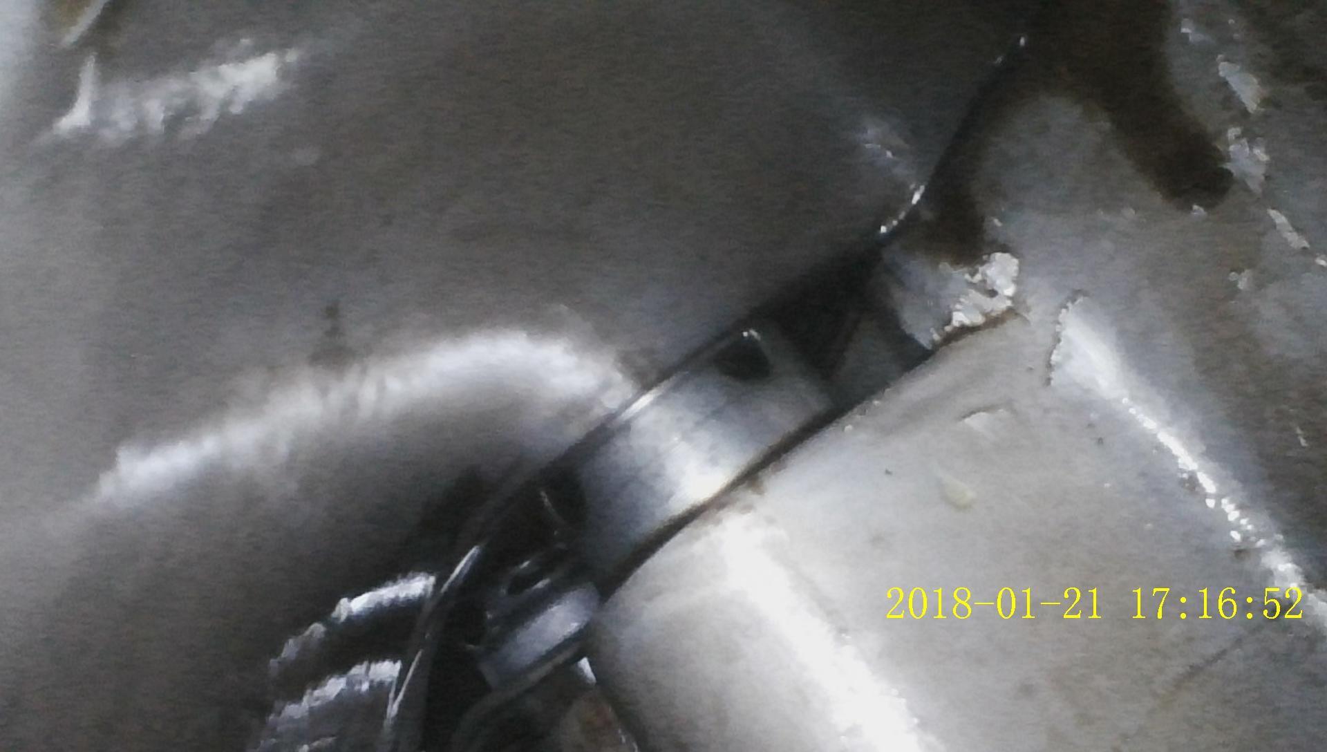

*update* yesterday I got heads and pistons cleaned up, pulled timing cover and oil pump and swapped cams. Tonight I'm going to do valvesprings because I didn't get to them yesterday. I've also decided to leave the oil pressure relief valve in the oil pan for now because I don't have much time before my cross country trip. I intend on replacing the valve later on. I inspected all the valvetrain and it all looks good. I found OEM plugs on all but cylinder 7 which had an aftermarket AC delco plug (possibly related to previous owner cyl 7 misfire?).
I shoved a borescope to the back of the oil pan to inspect the high pressure oil relief valve. I'll attach pictures in another post. Perhaps someone can advise from the pics if it looks like the oil pressure valve shrowd is installed as directed in the TSB

Not sure why it looks like there's two valves??? That can't be...
Doesn't look live the valve has a shrowd either.
