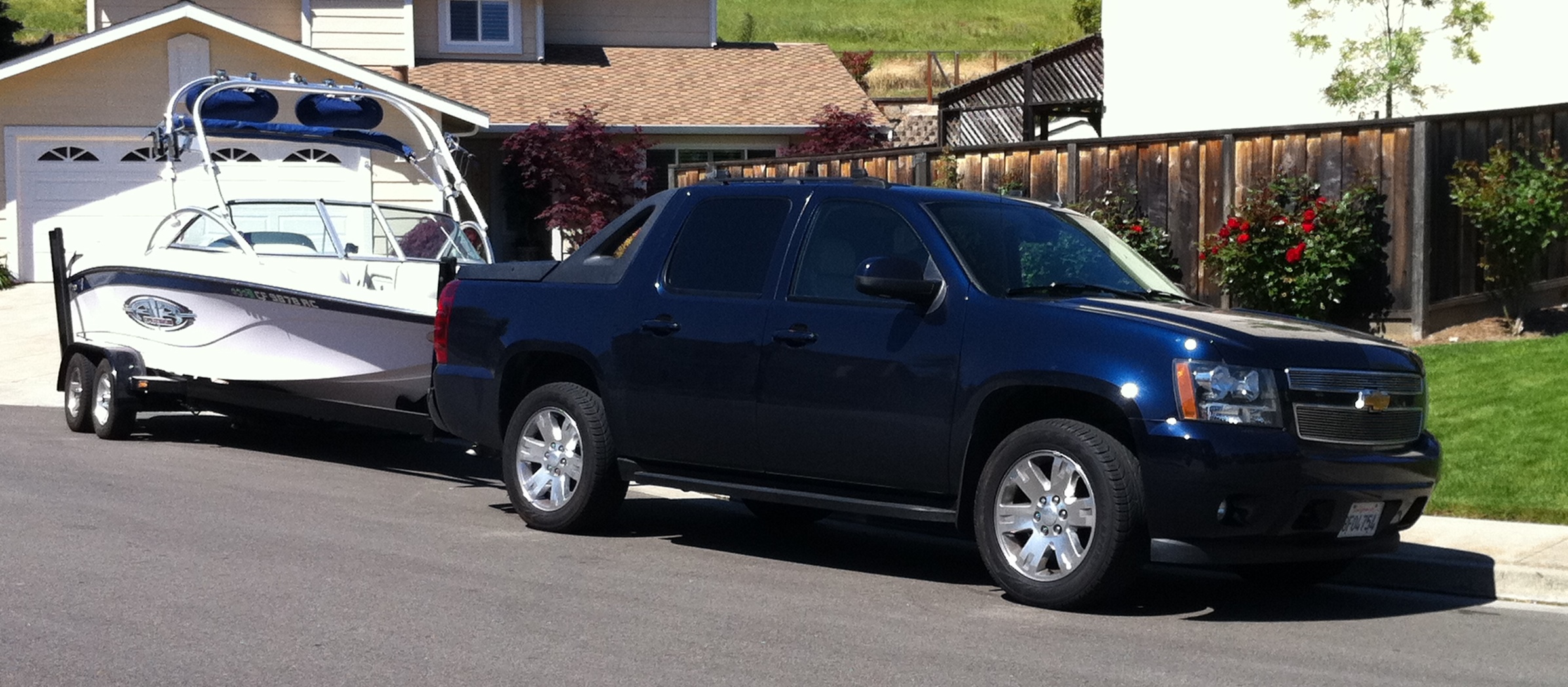

2007 Avalanche blown 6.0 LQ4 replacing tired 5.3
Starting a new thread for my truck as I have figured out a few things on my build. If you saw my other thread you will know that my Edelbrock E-force Supercharged 5.3L engine finally started smoking and burning oil at 145k miles so I finally get to put a stronger motor under the blower. The truck (SUV) is a 2007 Chevy Avalanche stock except for the supercharger and tune. Currently tuned on the dyno to 365HP at the rear wheels (exactly what Edelbrock told me it would do).
The new motor I just purchased is a new ATK HP93, rebuilt LQ4 with cam they claim makes 450HP with a carb and headers. Mine is going to get stock exhaust manifolds and a mild tune so it can still pass CARB smog tests. The Edelbrock blower is CARB listed so everything I do needs to pass the visual and sniff test. I guess the blower will add about 100hp and that's plenty for my needs, I plan to run the 3.5" pulley on the blower so it should be pushing 6.5-7 lbs of boost. I know the motor will take more but I don't want to go through the rest of the drivetrain. I will address the transmission in another thread as I am currently debating between a stage 3 fresh built Xtreme transmissions 4L65E or a good low mileage junkyard 4L80E.
