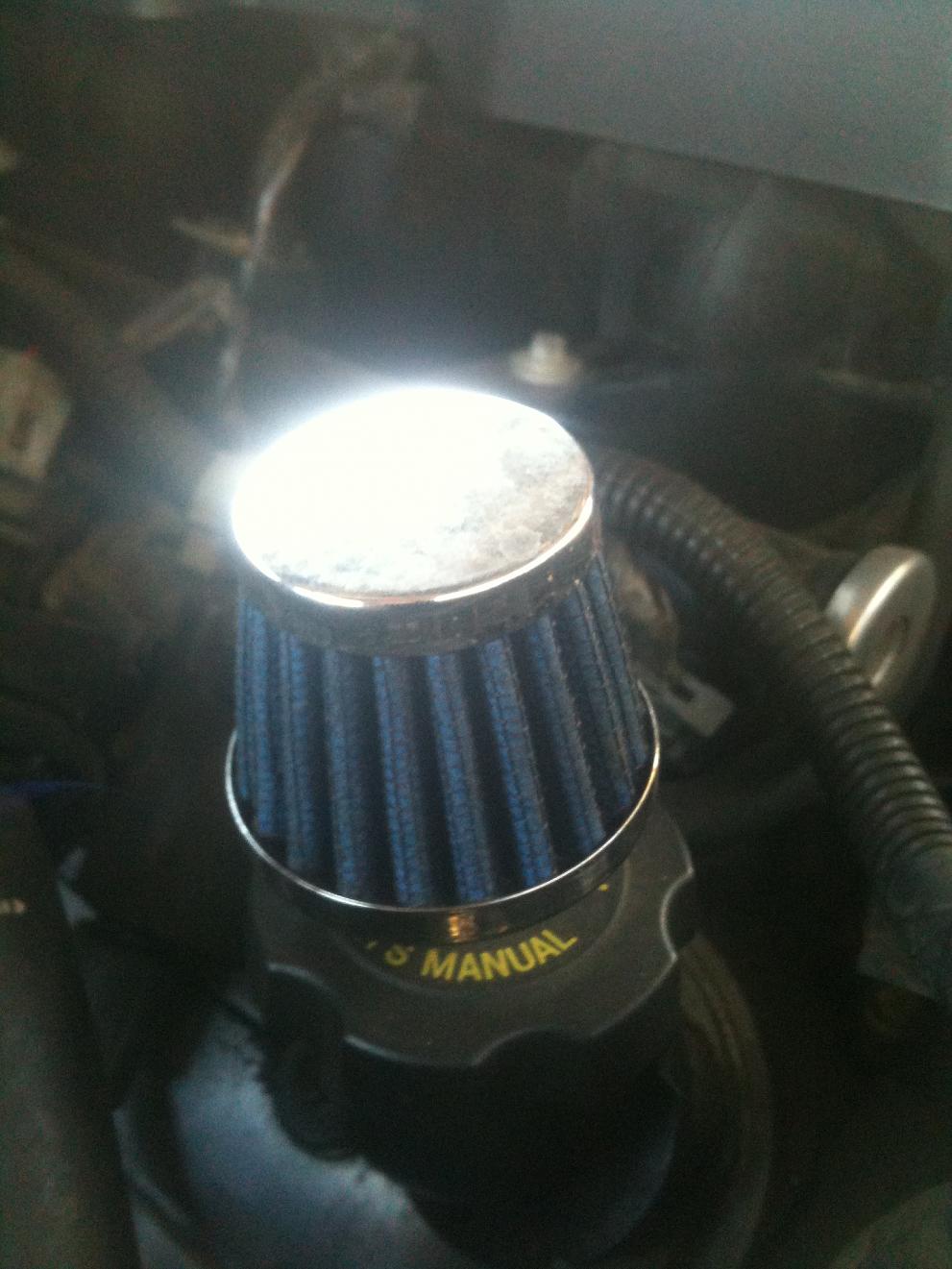

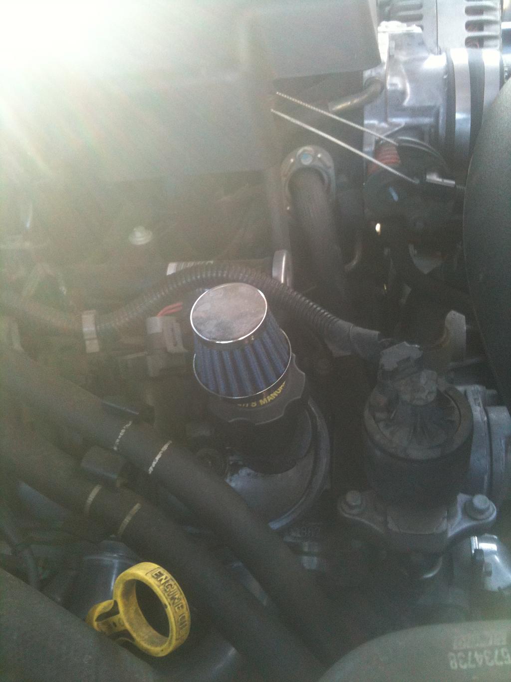

Auto zone or o'rileys
Trying to figure out how to upload the pictures of it I took
It's a lil filter about 2" diameter in a cone shape
Under neath the filter is about a 3/4" diameter rubber hose attached
On the oil cap drill a whole just barely small than 3/4" for a snug fit.
If you drill out to much of the cap you will break/go through a plastic ring..... No worries if you do just drill out the whole ring and MAKE SURE ALL PLASTIC PIECES are cleaned. Don't want plastic in the motor lol
