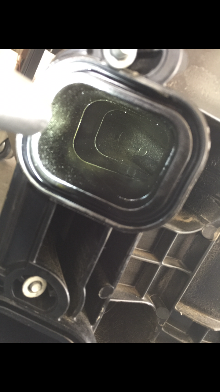

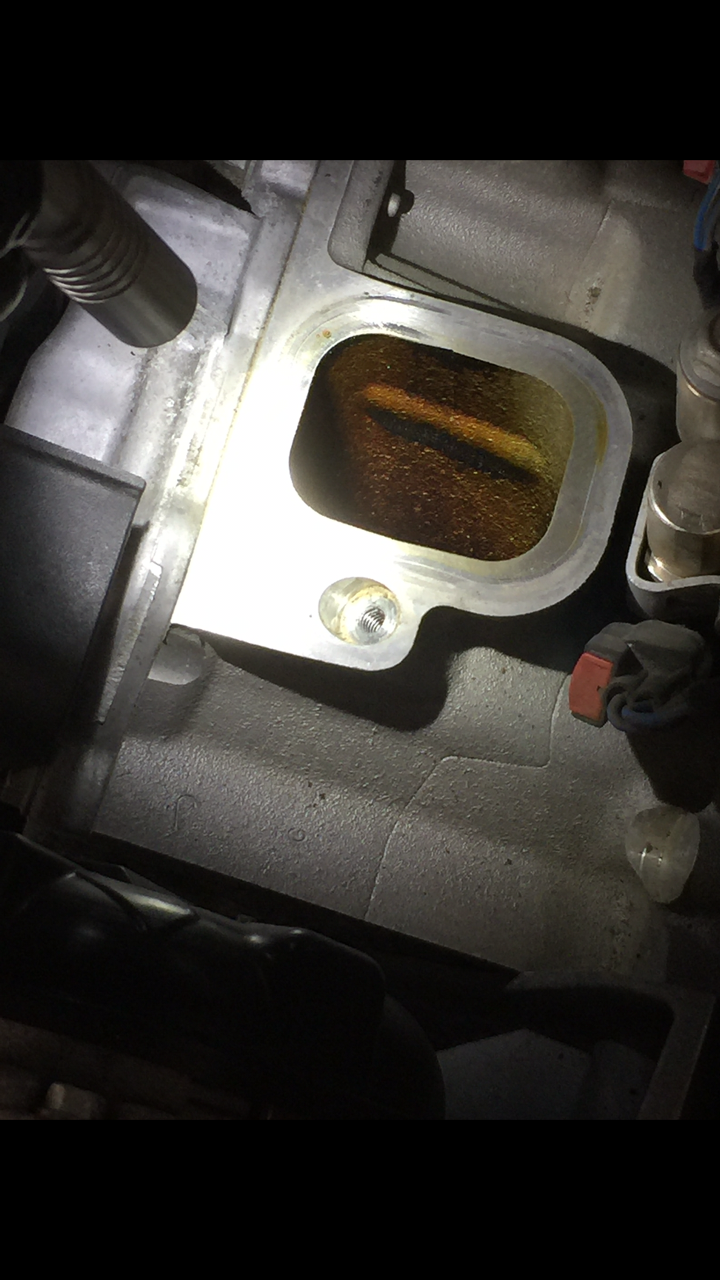

Edit: 2014 Sierra 5.3
I was surprised how clean everything was for being direct injection. I've been worried about the carbon buildup with direct injection and watching a ton of videos of people cleaning them with walnuts or spray cleaner. I really thought mine would look a lot worse than this.
I went and talked to a guy that's the service manager at the local GM dealer and he said they really don't see any problems from buildup, that's before I took these pics. So considering how mine looks and what he said, we may not need to worry about the buildup causing problems like on some other DI motors.
I did do an induction cleaning 3k miles ago by misting a cleaner into the throttle body but I doubt it really did much.
I know at least a few of you are curious about this so I took some pics while replacing my injector seals last week.

About 200 miles before the pics it was turned off. I got it tuned on a Saturday and I pulled the intake the following Thursday.
So this is 117k miles of AFM, stock tune, no catch can, no nothing, just a stock truck with a K&N

I think I posted mine when I put the blower on in Jan '16. Looked virtually identical at 14k. Great to see it doesn't get worse.

I had it built up in my head that there was gonna be straw sized ports due to all the buildup, I was really happy to see this.

No problem and I hear ya, I bought my truck and the fear set in, the DI and the weird noises they make drove me crazy for about a week. They make strange sounds and I thought I had several issues going on, turns out it's all normal for these motors.
I was first surprised when the service manager at the local dealership looked at me funny when I asked how often they are having to do valve cleanings due to the build up from DI. He gave me a "whatttt" look. Then I pulled the intake and now see why he gave me that reaction. Apparently GM did a really good job with the PCV system baffling etc to keep the buildup at bay.
When you're ready to take the plunge on a newer DI truck, do it.
