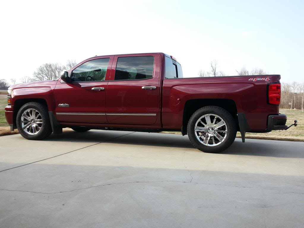

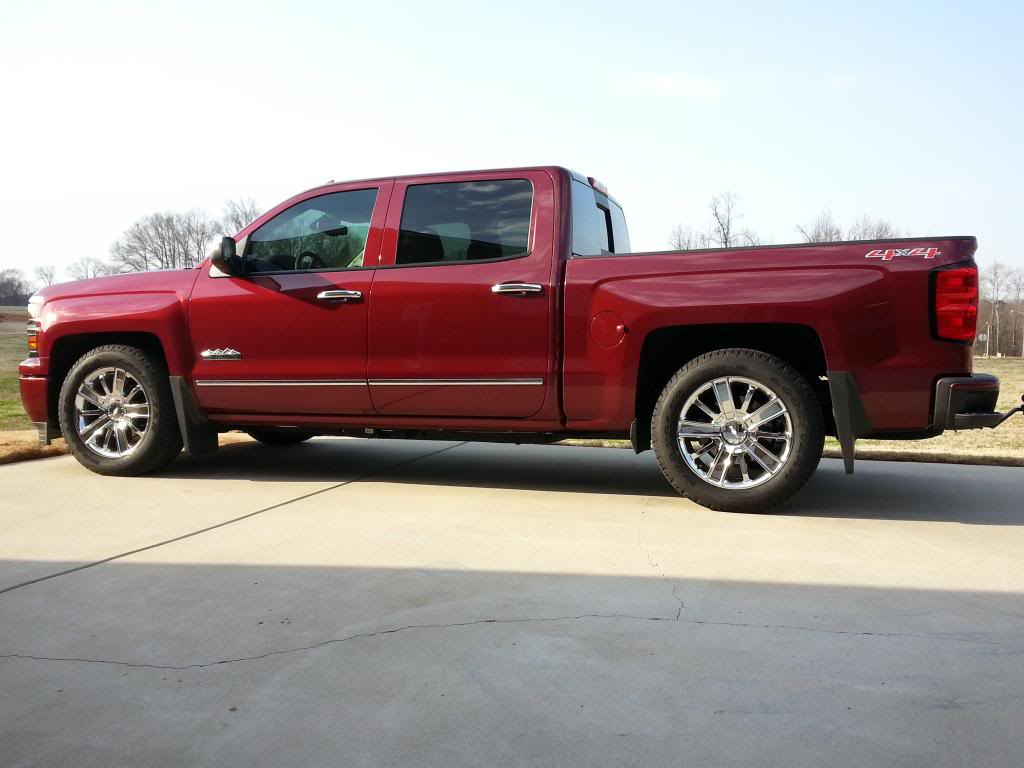

Took the step bars off and looks a TON better. Had some big holes in the fenders where the splash guards were so I put them back on... Maybe with some chrome trucker girls on them I might like em better.

Truck looks great ! Glad ya didn't put black wheels on , I like those they are different .

yeah i hated that when i took my flaps off they left 3 holes in my fender. would look better if they were off if you can live with the holes.
