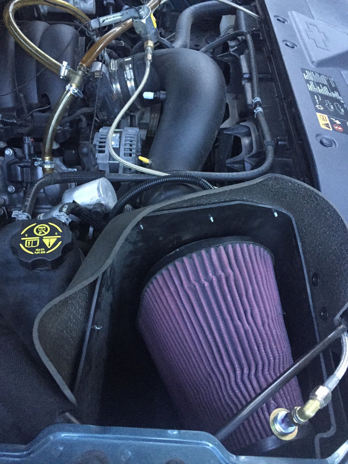

Post pics of CAI

Pics posted. It was leaking slightly on the breather. I disconnected and plugged and that helped, but not enough. Catch can ordered. Still seems like the high numbers are at or slightly above idle.

Whats up with the hose reroute and plug before installing a catchcan? Have you tried replumbing it to factory and checking trims again?

I plugged the connections to see if readings would change. The trims are better, but they are still off. There has to be something else...

You should probably clean up that solenoid wiring while your in there. Also get some regular automotive grade hose that can tolerate petrol products and heat.
