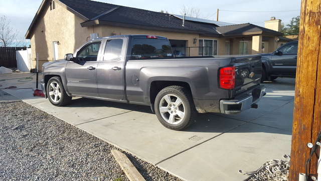

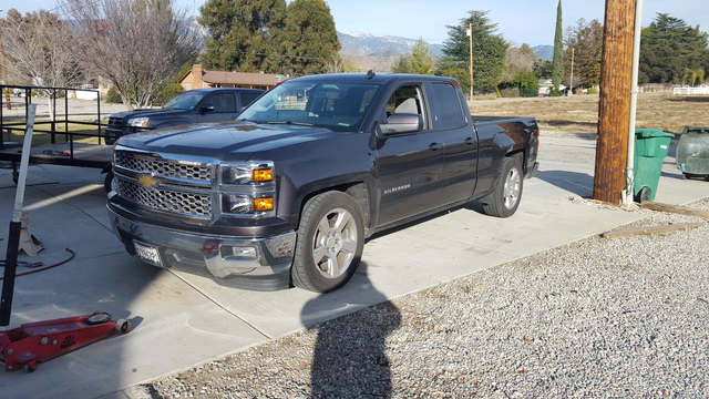

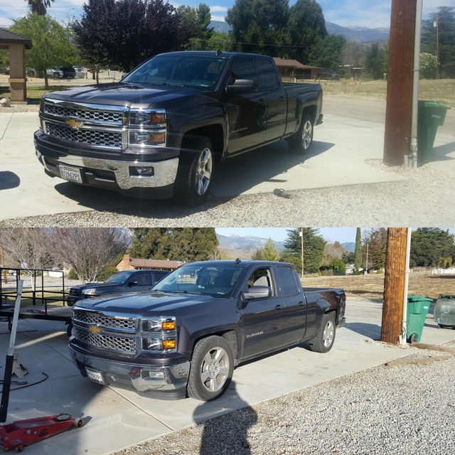

Got my lowering kit installed over Christmas weekend. Im pretty happy with how it looks. Amazed how many places it rubs now. Ill have to get used to that. Yes i know the truck is filthy. Didn't have the time to wash it before the rain started
Before/After
