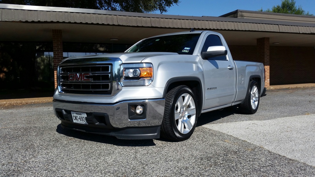

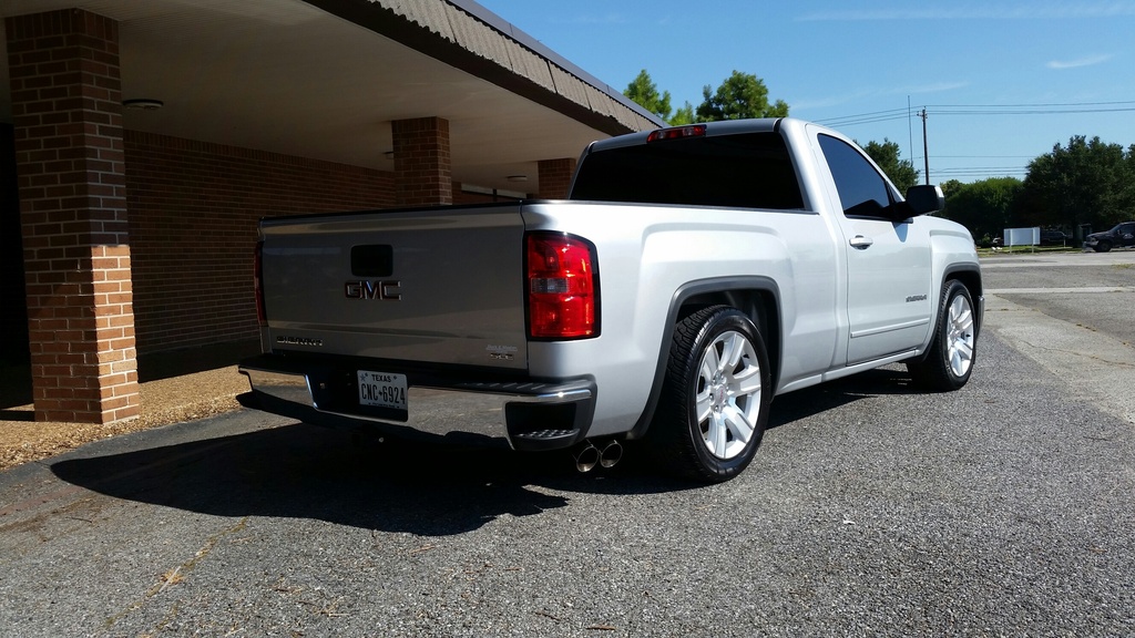

went with a mcgaughys adjustable 4/6 drop on mines
adjustable strut and spindle up front & rear flip kitt in rear with lift shackle, installed the stock shackle one went 1'' lower sitting at 4/7

Old Feb 17, 2016 | 08:48 AM
Joined: Apr 2010
Posts: 42
From: houston
Originally Posted by markjowens
Did you use the "C" notch kit from them for the 7" rear drop?
no sir no c notch on mines, use to bottom out with the shocks that come with the kitt, but switched to street performance shocks and runs smooth as hell bearly have any clearance and cant put anything heavy in the back but its not my daily so doesnt bother me!
