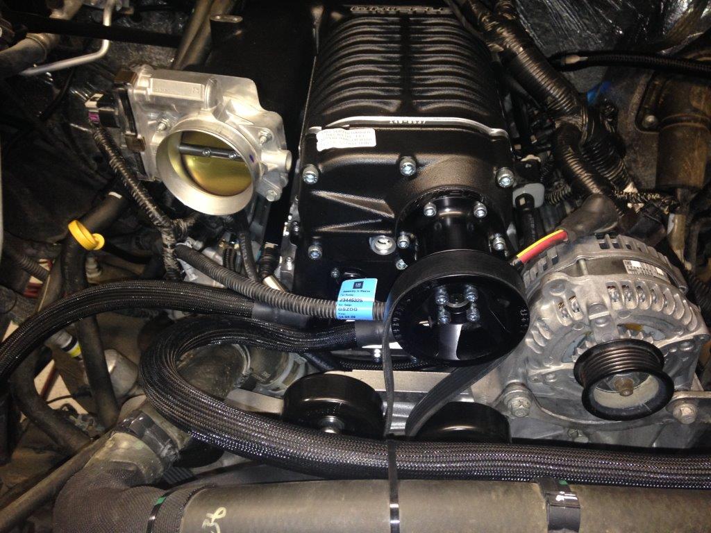

Shooting to pulley the blower so that the motor actually sees 11-12psi.

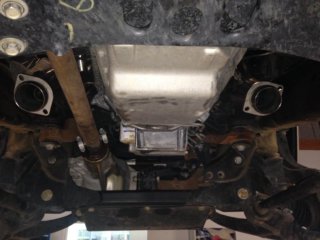

Ran into a couple snags, but nothing major. Should have the truck back tonight. The LT's that were originally received had the wrong flanges. That caused a couple day setback to get the right ones. Then the catted Y-Pipe sent, ended up lacking 18+ inches from meeting the factory cat back. Because I need my truck back, a spool piece was fab'd and put into place for the time being.
Corsa says they won't have a catback for the truck available until after the first of the year, so hopefully by then we'll have the proper Y-pipe and can replace the current one when doing the catback.

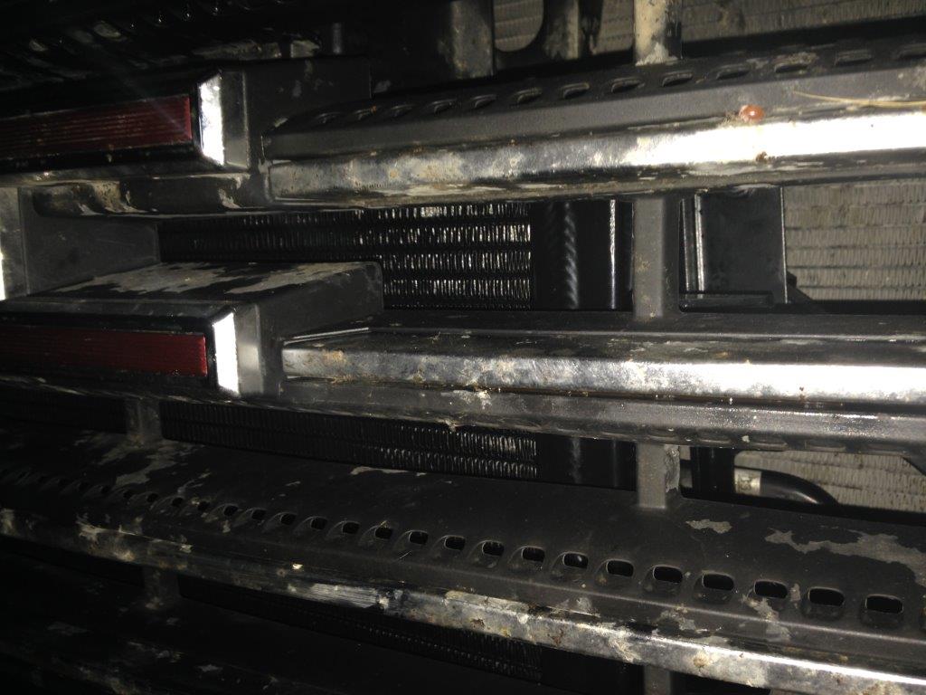

Did get to here the truck cranked on Friday. Here's a few pictures and a quick exhaust video for now.

Leaving shop, they're still tuning on it. Last pull I watched was 490rwhp/473rwtq. Not sure on the timing, but haven't even started the meth or increasing timing much. Motor is seeing 8.5psi.
This is still on 20" wheels and 35" Nitto Trail Grappler MT's, if it matters. I want the motor seeing 12psi, so it won't be long before a pulley change.
