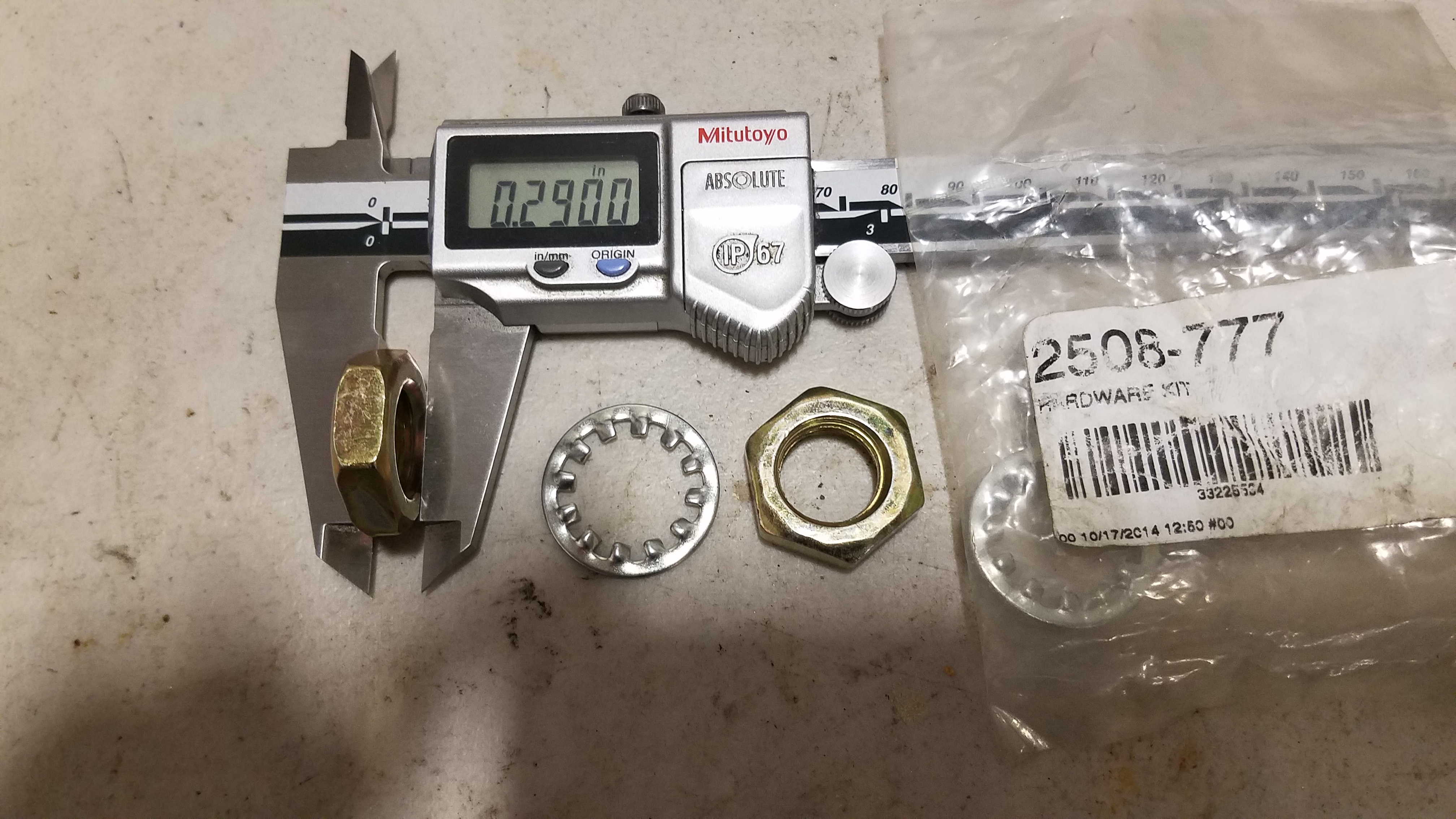

The new mcg kit has it. Mine didn't. Can you get me a picture of yours please.
I do have a part number from belltexh and I even called mcg. They're sending me some. But if still like to see it

I didn't use the hardware kit because i have 20" wheels.
