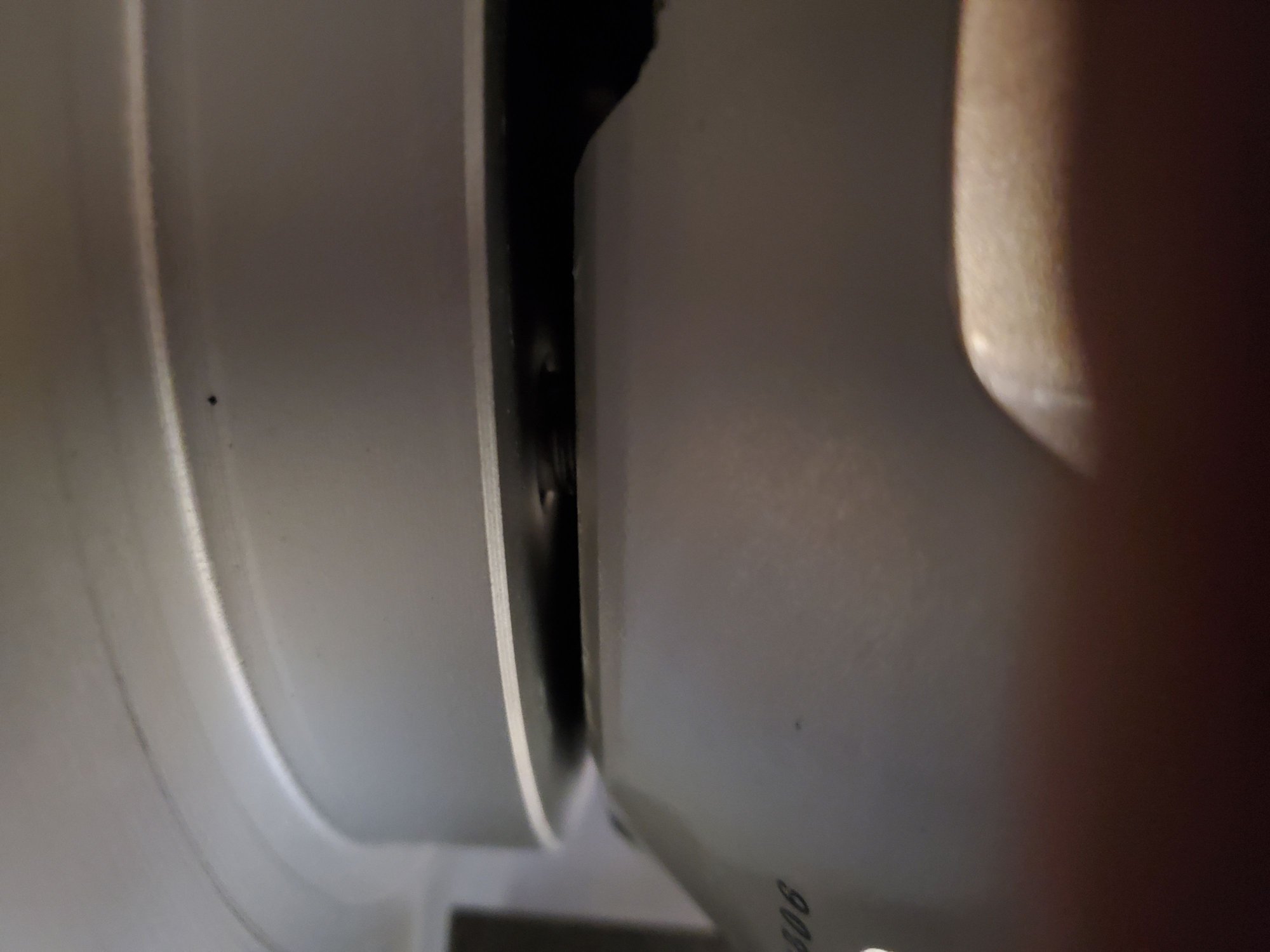

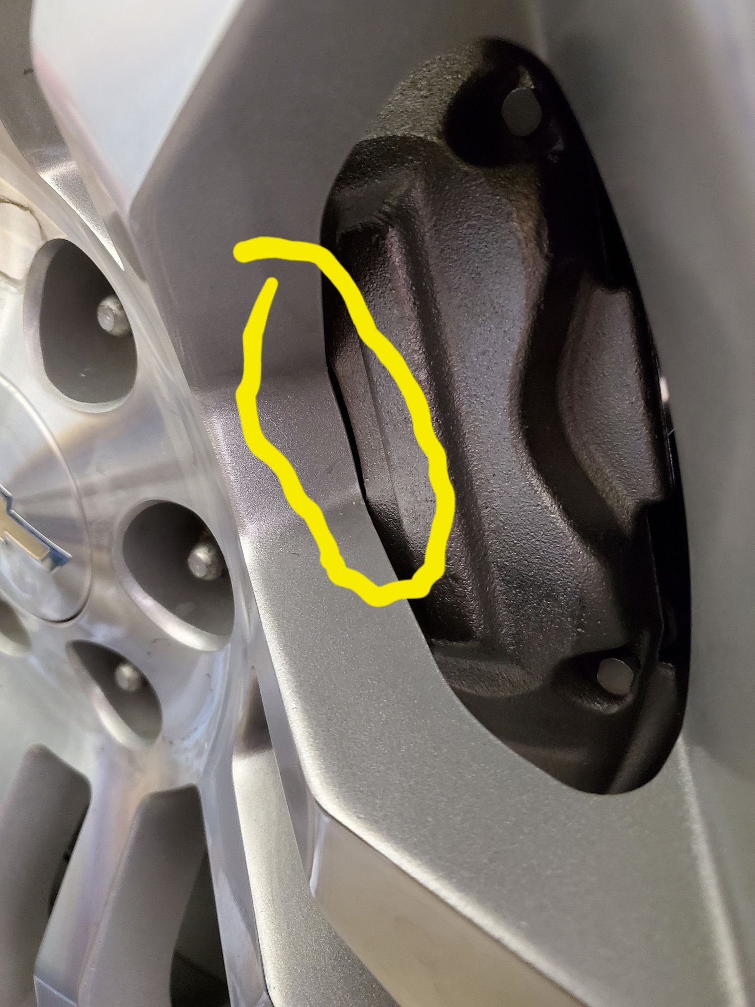

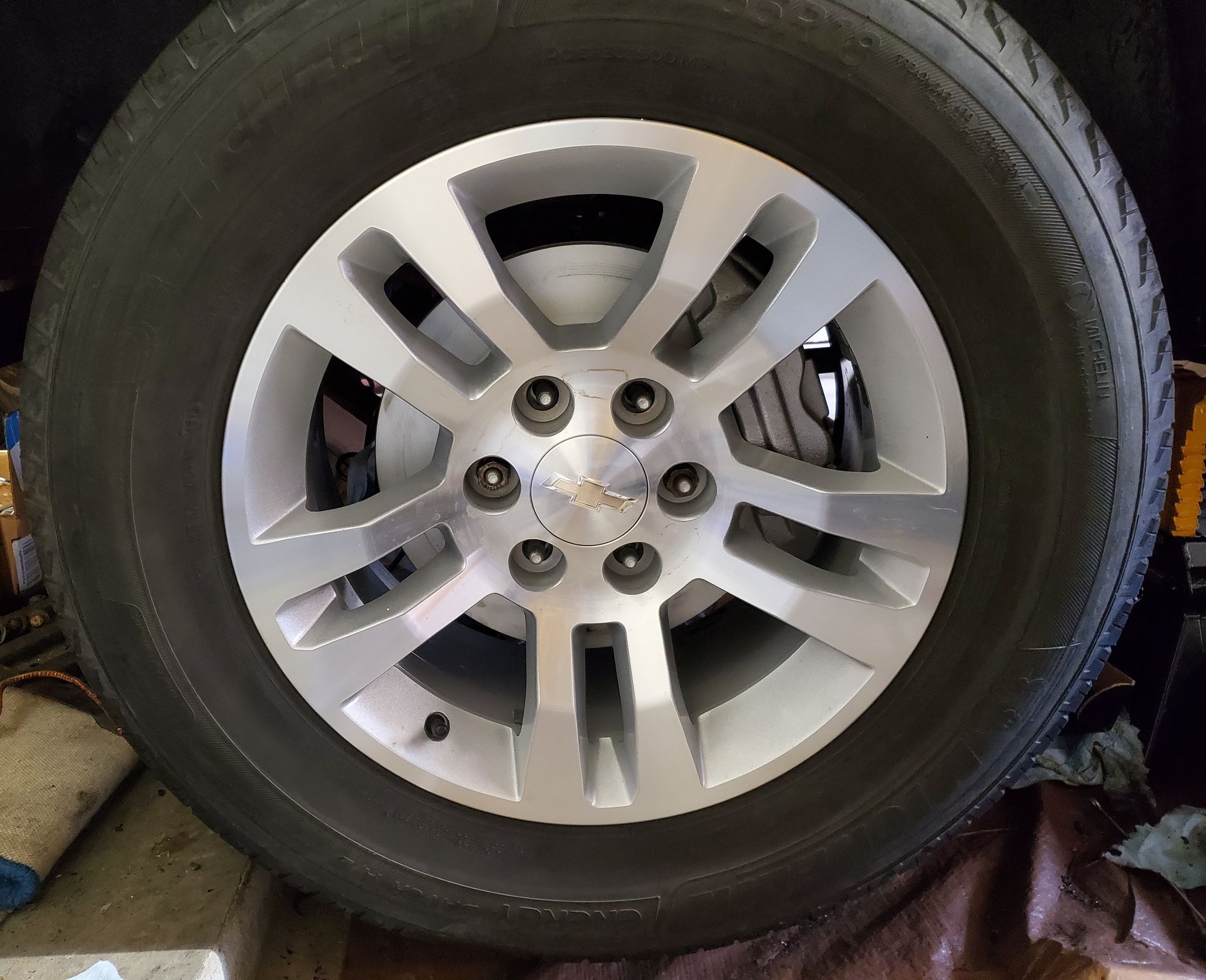

I can confirm that they actually do NOT fit. Bought a set to try. They will need at least a 10mm (3/8) spacer if not more to clear the bottom, outside portion of the four piston calipers. If anyone needs more pictures, ask and I'll try and take some different angles before reselling them.
These wheels do NOT fit GMT800 after adding the 4 piston calipers.
This is the not the minimum gap. It needs more room to safely clear the caliper.
It hits the caliper on the lower section of the caliper, not the hump.
