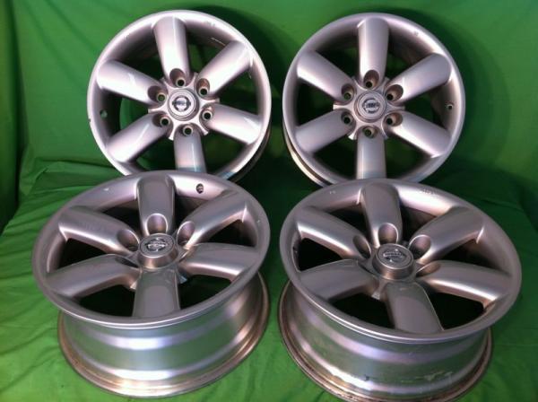

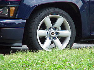

2012 down Colly wheels will fit, also Nissan SUV's, I got these
Titan wheels, there take offs from e-bay
Attached Thumbnails gm 6 lug wheels interchangeable-18x8-titan-wheels.jpg   gm 6 lug wheels interchangeable-01-6-23-12.jpg
