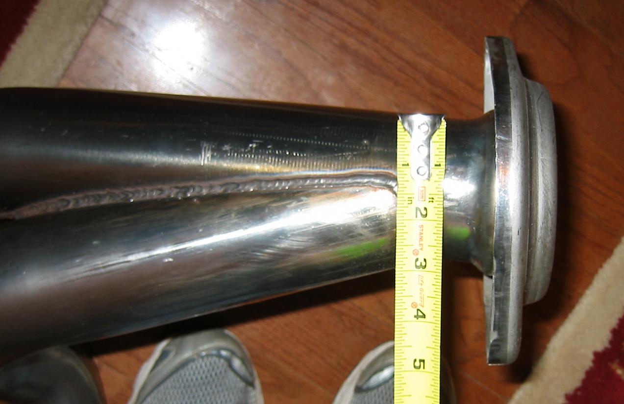

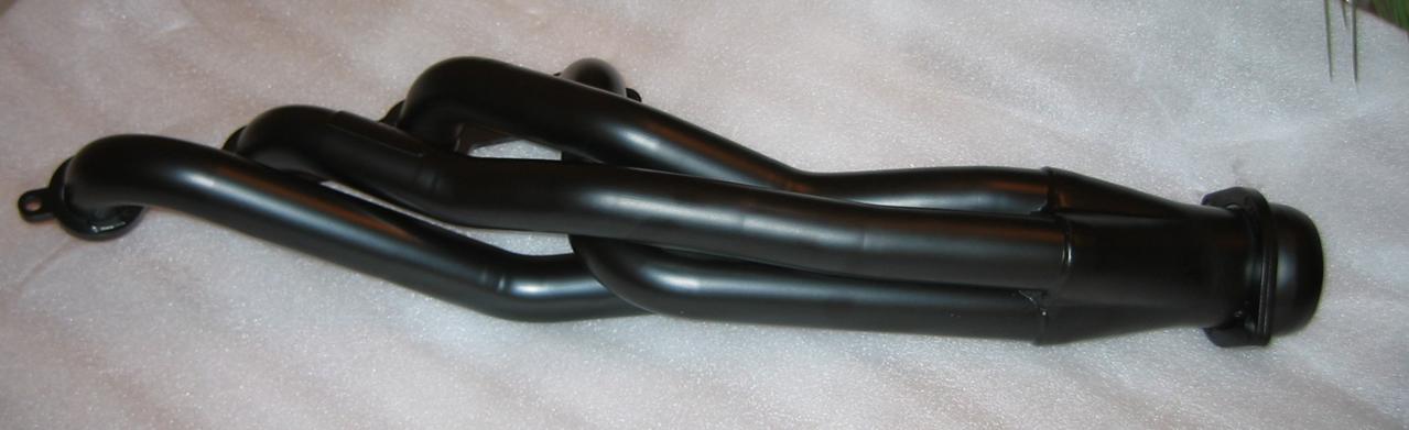

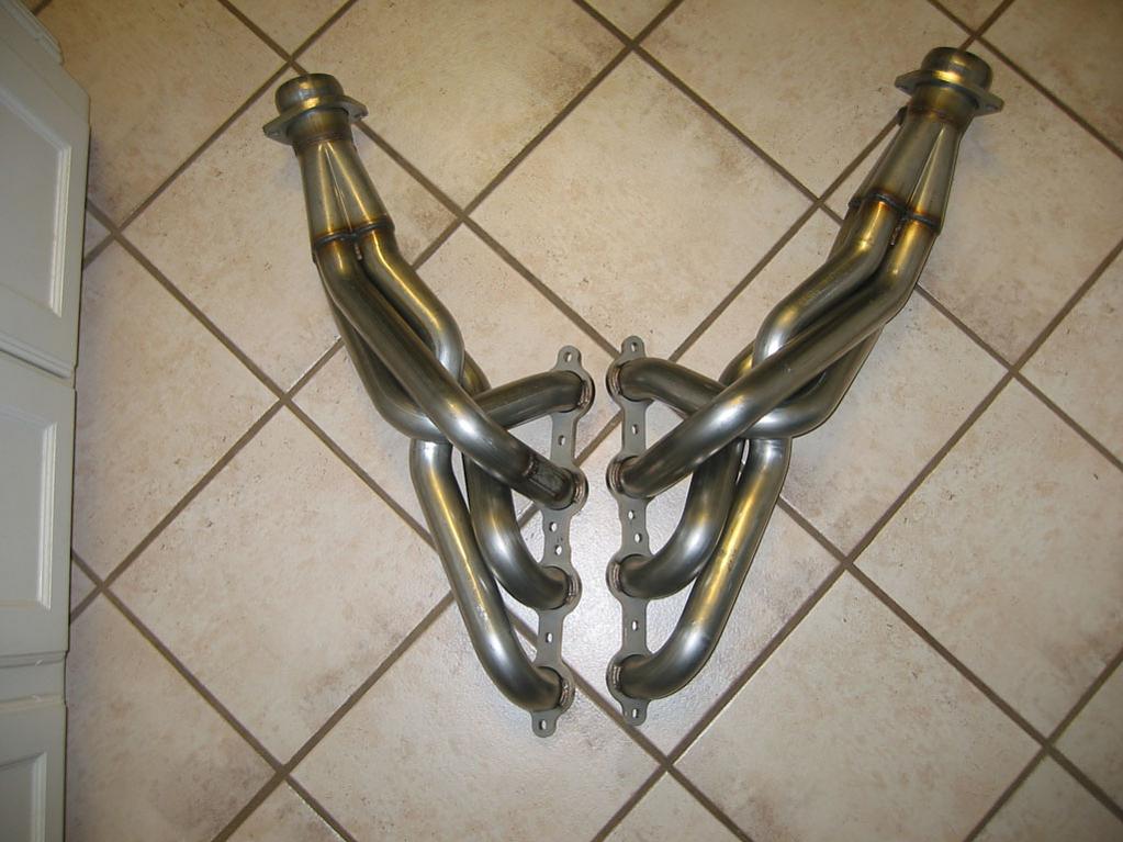

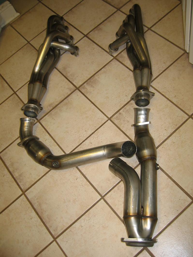

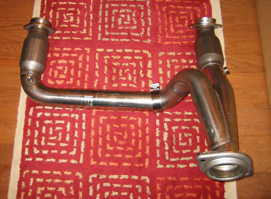

Here are the one's I've owned, both 1 3/4'' I ended up returning the Kooks for the AR's
AR pic's are 1st, last 3 are Kooks... Kooks Y has dual 3'' merged into a single 3'', the AR Y-Pipe is a little more open with a 3.5'' outlet
