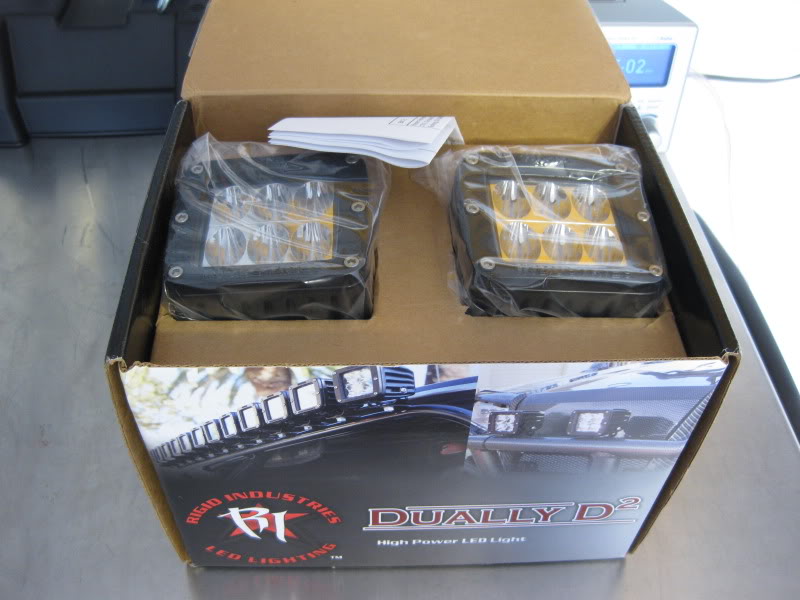

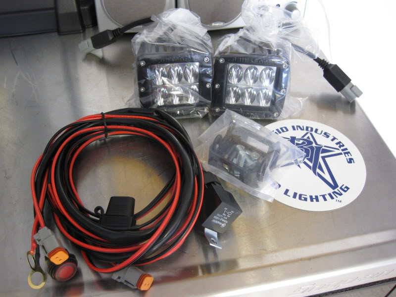

Here is what I ended up with, a set of the Rigid dually D2 led driving lights. I really wanted the led light bar but thought these would be more versatile in a number of different mounting locations. I have a denali grill and am going to mount the lights behind it. After I get the everything installed and wired up I'll post more pictures.

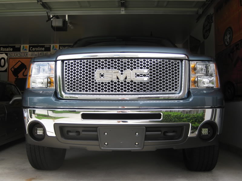

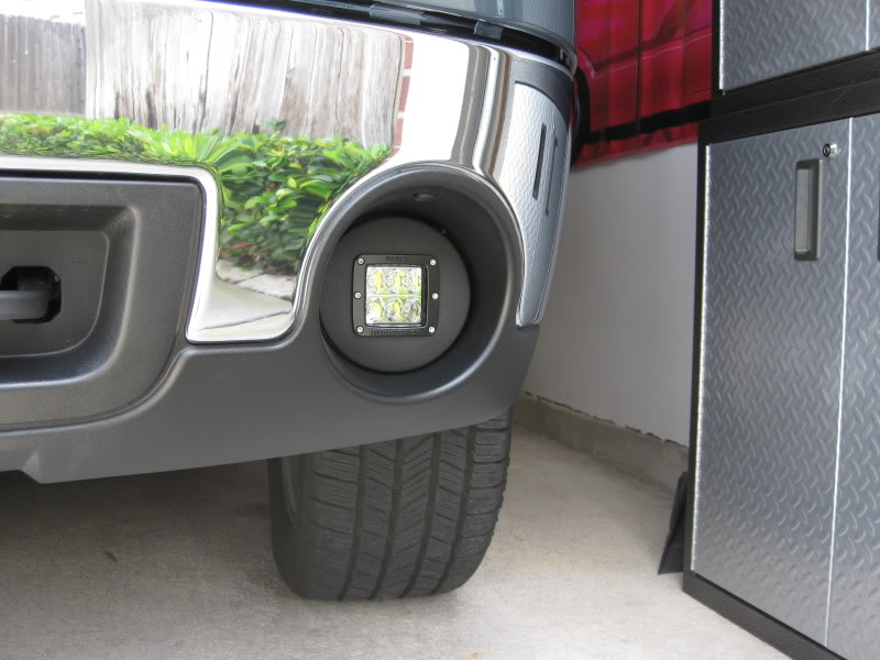

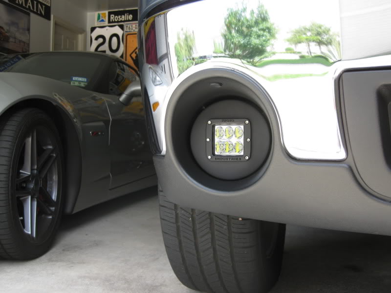

Finished up the lights, here are a few pictures. Will add some night time shots later tonight after it gets dark. More pictures and information below for those that care or want to do this for themselves.

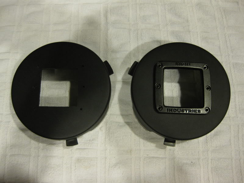

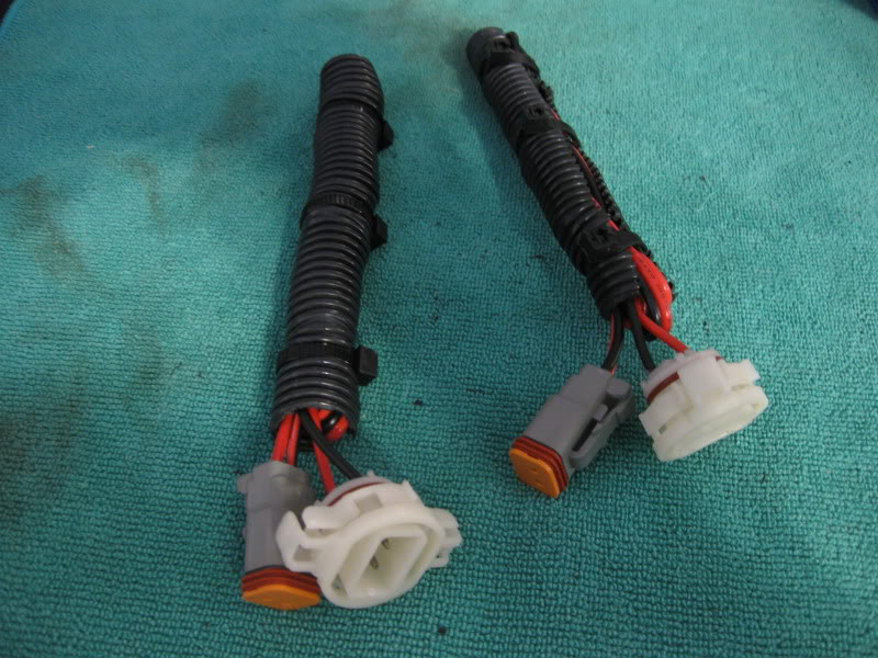

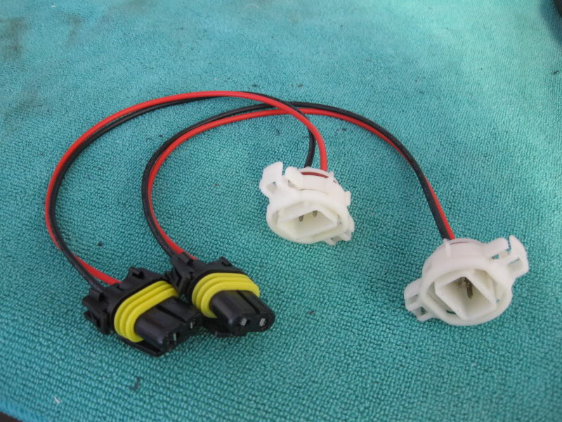

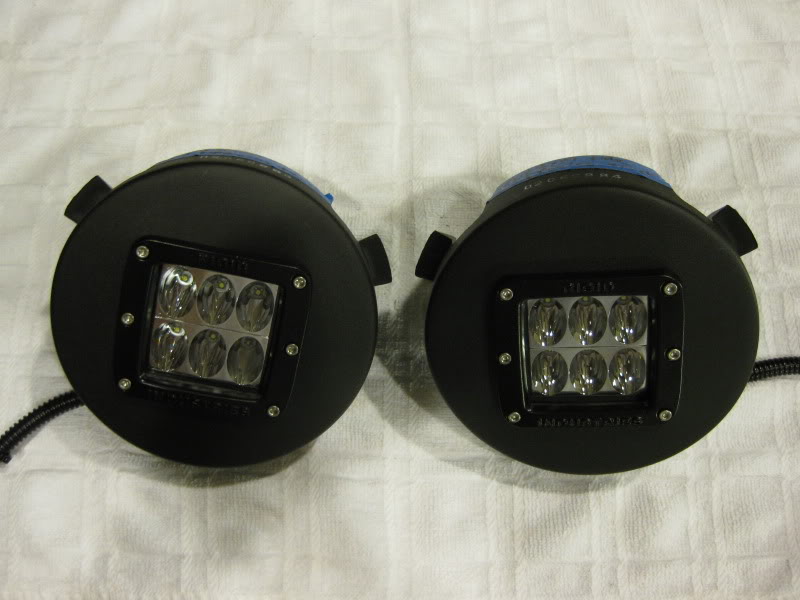

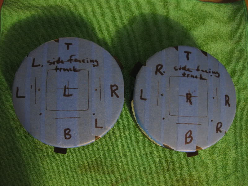

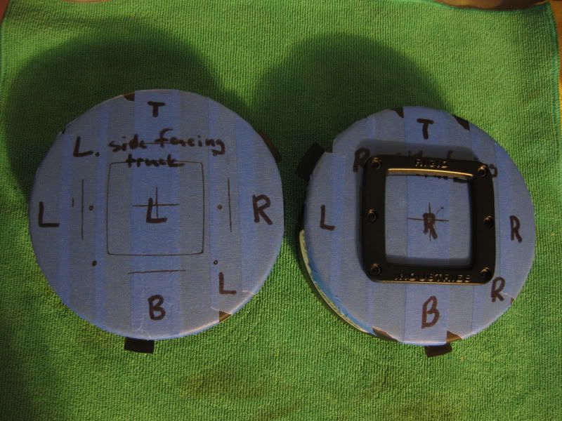

I first mounted the lights behind the grill but didn't like how it turned out so moved them to the fog light location. Behind the grill would work great if someone wants to run a light bar. Think you could easy fit up to a 30". My truck came with factory fogs so I purchased a set of blanks. Cut square holes in the blanks the size of the lens of the led lights. Took the face plate off the led light and picked up some longer screws to account for the additional thickness of the blank. The lights are solidly mounted in the blanks and also attached secondarily from behind. The factory valence required very slight trimming to accommodate the depth of the led light housings. The led lights come with their own harness and switch but I retained the factory switch/wiring since the factory fogs are already fused. Picked up a 5202 bulb adaptor harness to use to plug into the factory wiring and wired in the rigid plug to attach to the led lights. If anyone is looking to do this I'm happy to answer any questions to help out. Here are some various pictures I took along the way.

That looks pretty neat, clean install.
How bright are they? Get some night time shots

Where did you get the 5202 bulb adapters?
Old Mar 17, 2012 | 07:37 PM
Joined: May 2002
Posts: 183
From: Houston, TX
Sent you the info.

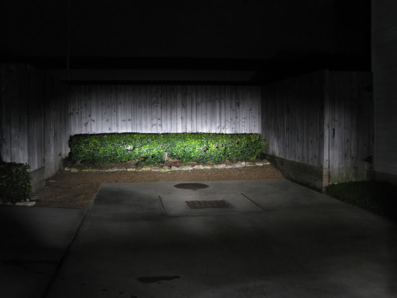

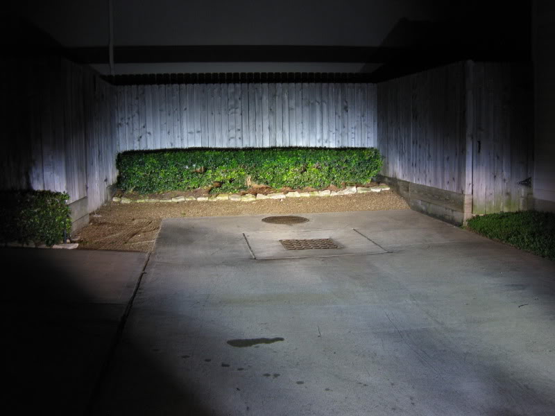

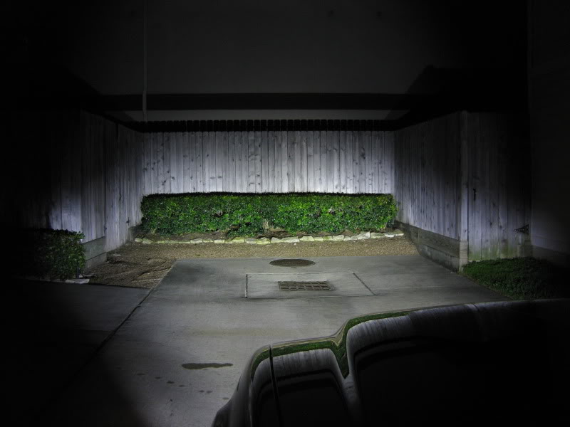

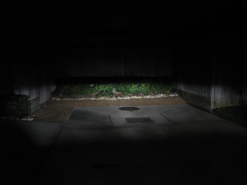

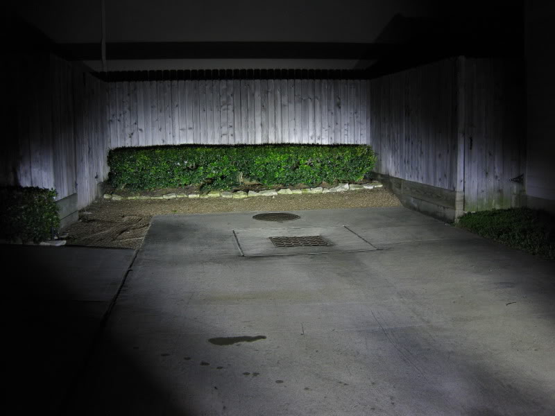

Here are the night shots. The bushes are about 45 feet away from the front of the truck.
Low beams -
Low & high beams -

Low beams & LED lights -

LED lights -
