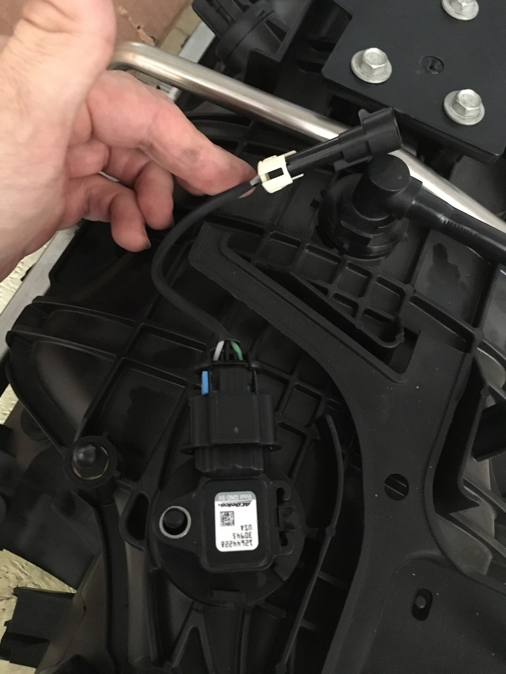

Here's I picture I took when confirming that everything plugged in correctly.

I have no problem buying the tbss connector and then soldering in the new one, but will the PCM be able to read it?

I was afraid there my be some type of issue like that. In my post above I meant to say since I haven't completed the engine swap that I couldn't confirm that it worked in the truck just that the adapter plugged in correctly.
Maybe there is a way to correct for the sensor in the PCM program?
It would be so much nicer than having to rig up the wrong sensor and always wonder if it sealed good enough.
