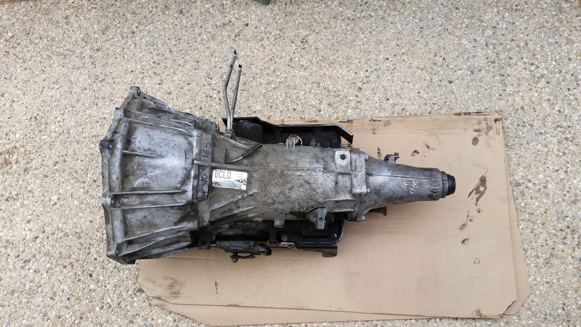

Was it a 2wd or awd? Most of the denalis are awd... Got a pic of the back of the trans?
Old Jun 15, 2016 | 11:23 PM
motohead911's Avatar
Joined: Apr 2013
Posts: 75
This is the best photo i have right now

Im guessing the 4l60 had the 8" or whatever it is tailshaft housing?
Old Jun 16, 2016 | 12:07 AM
Joined: Apr 2013
Posts: 75
Here is the old trans.
Old Jun 16, 2016 | 12:20 AM
Wolftrk99's Avatar
Joined: Jun 2013
Posts: 5,492
Likes: 48
From: Virginia Beach,VA
Yeah thats the 8" tailhousing......probably need a new ds made?
