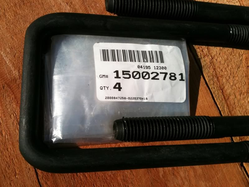

I used shorter hardware..

I just put some extra washers between the nut and the lower u bolt plate when I removed my blocks. I wanted to MAKE SURE I had enough thread. I will eventually put the factory NBS 2wd u bolts on. That is the 15002781 part number.
x2 on adding washers, thats all i did i think i used 4 or 5 per stud iirc. box of washers is cheaper then new bolts, unless yourdead set on factory appearence.
