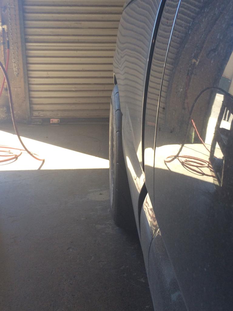

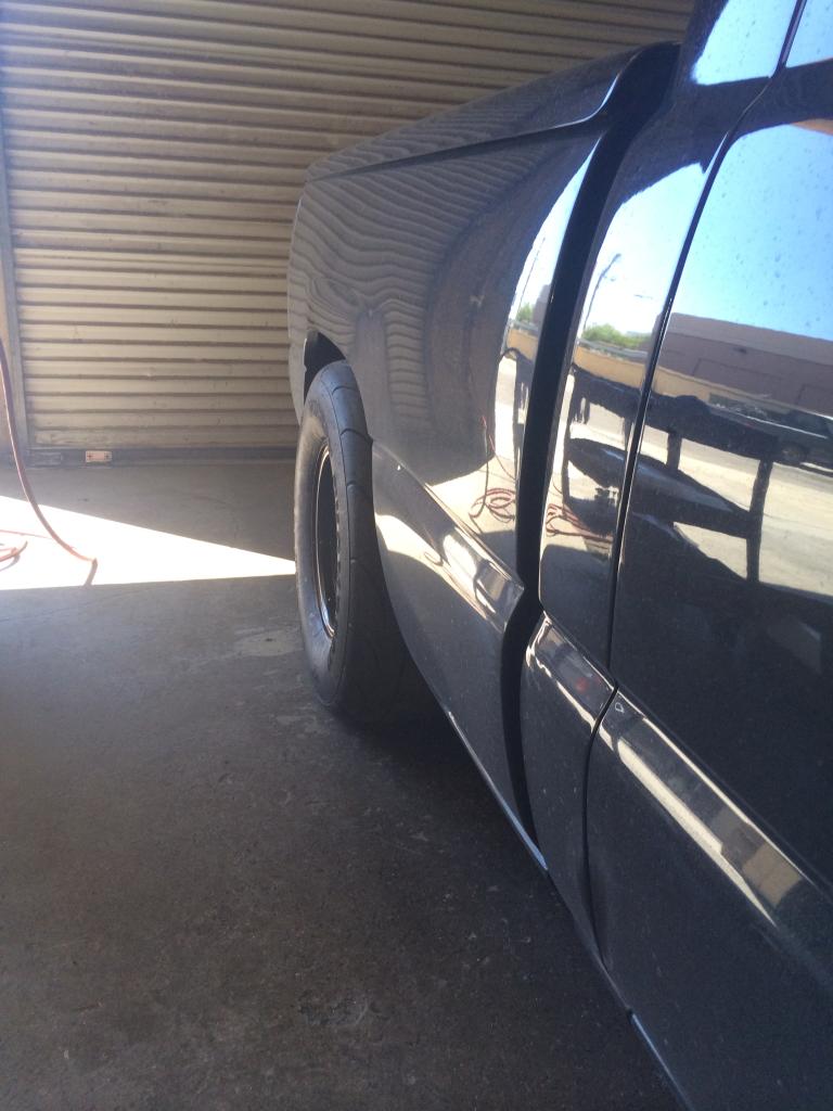

If you need it to tuck and you want to run a 15x10 wheel, you will need to run 7.25" BS and the 315/60-15 tire will tuck. I am running that tire on a 15x10 with 6.5" BS and it defiantly will not work with a 7" drop.
Here is a pic of my set up lowered about 5" in the rear.
