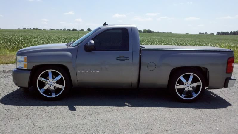

Belltech flip kit, straight out of the box. Stock shackle and hanger. I posted the picture so you can see how it looks in the wheel well. Flip kit with a lift hanger will get you a 6", (maybe 5", it's been awhile since I've looked into these). Even then I don't think you'll be able to keep the bumpstop bracket, especially if you are an extended or crew cab. I didn't have time to cut my bracket off the same day as I lowered it, and with my 7" drop, the bumpstop with bracket was only about an inch from bottoming out. My truck was unbearable to drive that week.

^^^^ Sharp looking truck! I appreciate your reply.
It's hard to see from the shadows in the pic, but I gather from your response that you're not able to notice the rearward location of the axle with the flip kit?

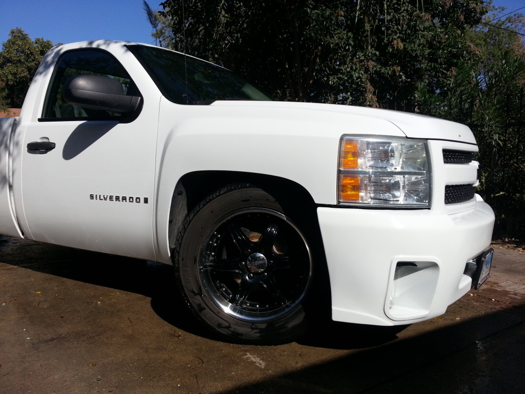

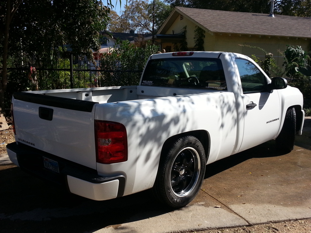

Heres a crappy shot of mine 4/7. No rear bumpstop. Havent bottomed out once and I had a whole 350 sbc on the back of it 2 months ago. Axle looks centered to me even though you cant tell in the pic.
