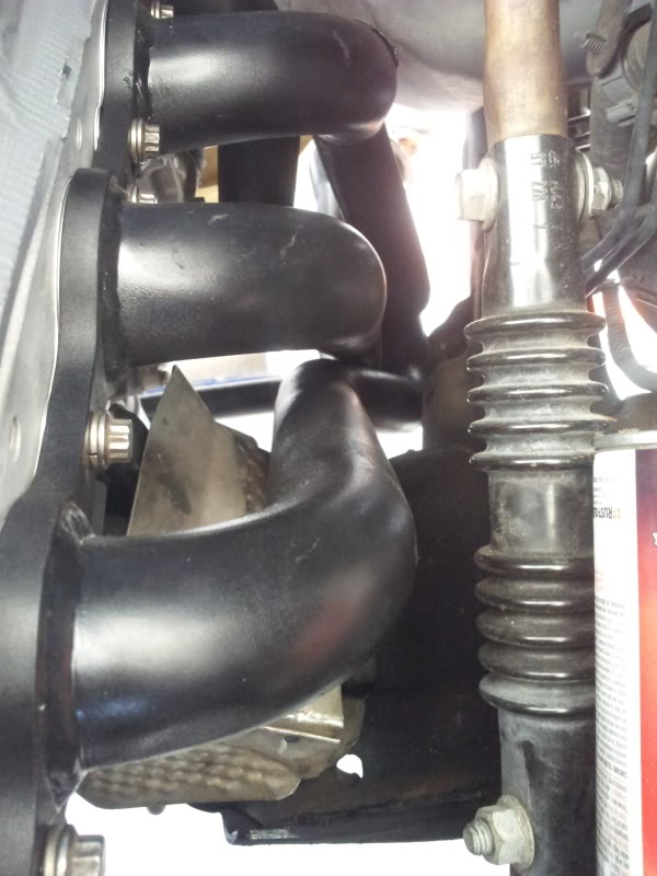

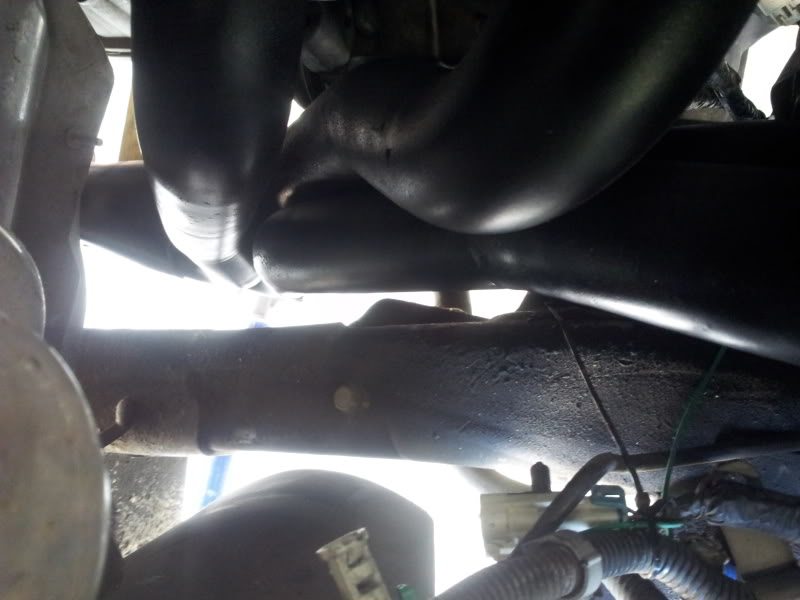

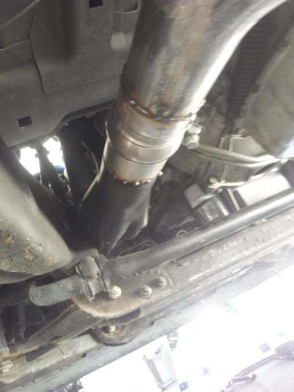

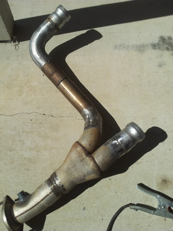

I run the gmt800 ones. The o2 sensor bungs are junk, removed their crap and added my own. Moved the passenger o2 away from the frame, deleted the egr port. Also built my own y pipe.
For 300.00 or so they arent bad, but i think if you have 500-600 budget you should look into a set that fits
