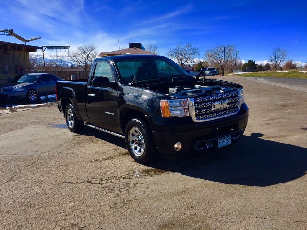

IT'S ON!!!!
I still need the emblem and the side support brackets fixed and attached but it'll do for now.
Thanks for the help guys

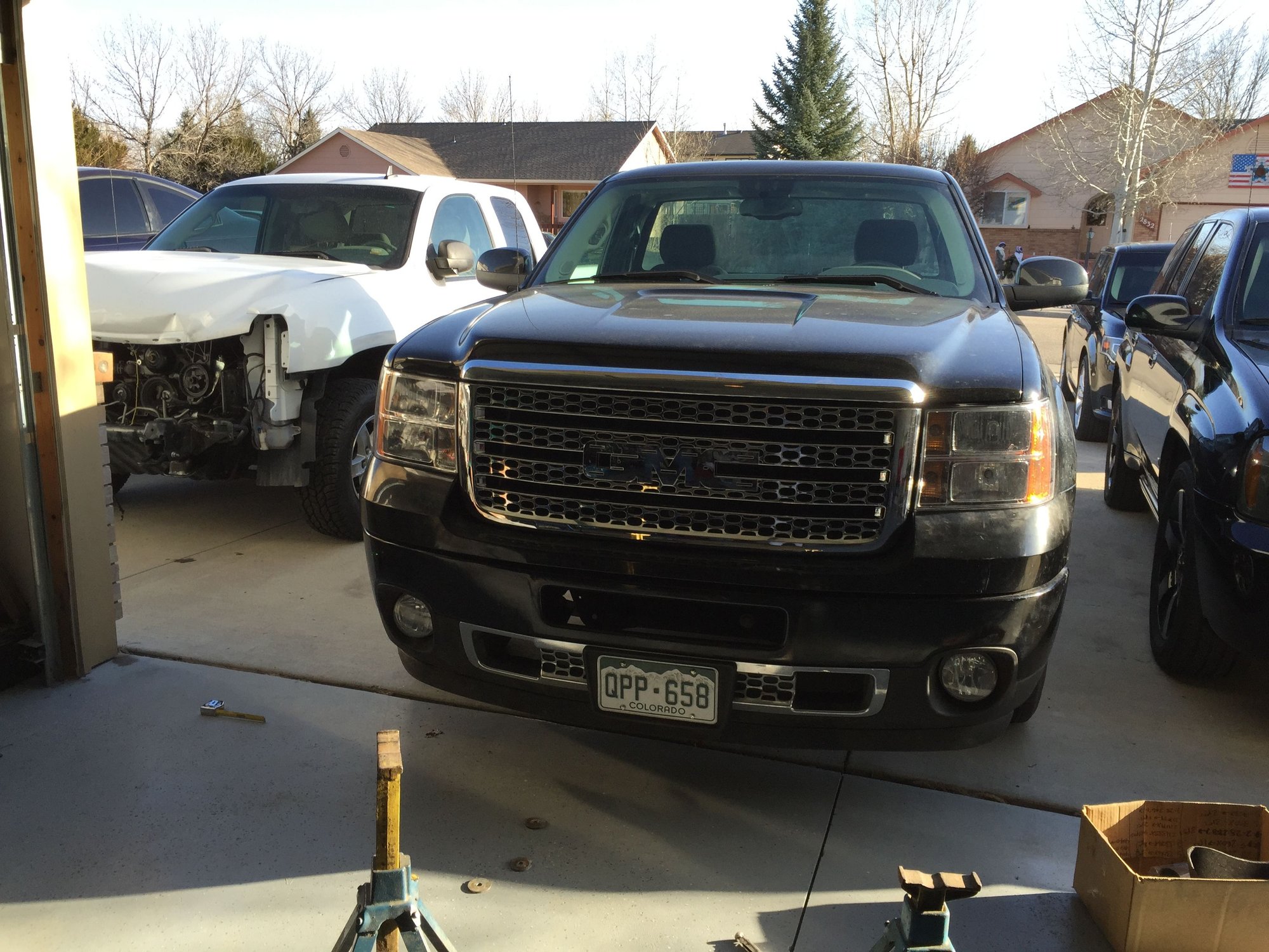

Posts: 95
One more since that last pic was pretty bad
