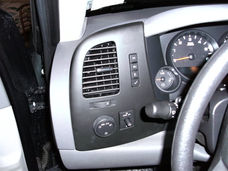

This is a common mod with the 07+ NNBS trucks but I havnt really seen a thread on here so I thought I'd put one together while installing mine.
Here is what I started with. I had very limited things I could watch without the DIC while driving such as mileage/trip meter/trans temp and I had to use the reset on the trip meter to scroll through them.

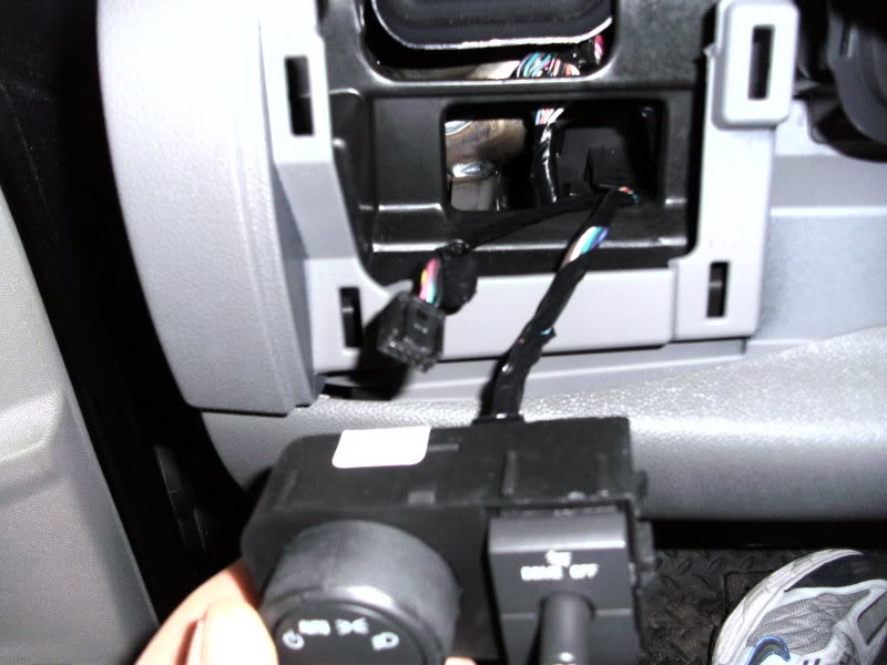

After prying on the panel I popped it off allowing me to get access to the wiring harness for the lights. With the help of a small pocket knife I unclipped the harness to remove the light switch to install into the new dash panel. The DIC harness is the small one above the light switch.
When you pull the panel off you'll find the plug for the DIC buttons is placed onto a piece of plastic (circled in red)to keep it secure while not in use. Simply just pull in off and plug into the DIC buttons.
