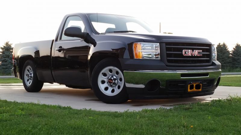

If it helps buddy I just did a 4-6 on mine with the mcgaughys 34070 kit and love it. The truck rides great. If you think you would like it PM me and I can get you some quotes.

i have the 34070 kit on my 2010 CC lowered 4/6. I had to cut the lower balljoint stud so I could run factory rims. Also the top balljoint on one side doesn't look like its seated all the way but I guess this is normal.
Those are my two gripes with the kit.
and if the ball joints are not seating properly that a huge problem I had this problem with another lowering kit with my old integra which caused the car to shift from side to side while in a turn nearly causing a wreck.
There is no cotter pin on the bottom or top, they should have nylon on the end of the nuts.
I've cut the end of the ball joint off my old 06 sierra when I ran drop spindles with 18in rims, no problems.
