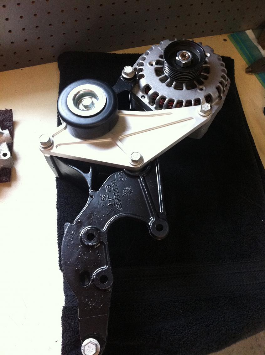

So the LS2 intake is on, factory tb and water pump. I had to clearance the water pump neck just a bit. The alternator didnt need to be moved just the idler pulley. However with the alternator sitting up so high I did relocate it for looks.https://www.performancetrucks.net/fo...1&d=1295193980
