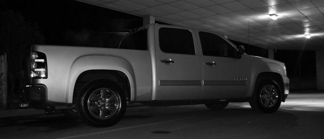

hey guys so this weekend me and boy put in my drop. we did 2in drop spindles from ground force in the front and in the back we did 2in shackels and block removal. i wish the back was a little lower but i didn't want to do the leafs zoo ima have to figure something else out. other then that though i like it a lot what do u guys think
sry about the bad quality dam blackberrys
also put in a pic of the cv angle for people to c
also missing them stock 20 in rims anybody wan a trade for stock 18 with 98% tred still left lol

heres a better one

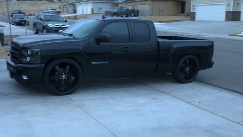

121, what lowering setup and wheels/tires are you running?

2" drop spindles and i cut one coil off the springs. 2wd rear leaf from ground force which is the same in the 4wd kit shackles and no block. 26" wheels

r u a little higher in the back or are your perfectly level?

I sit level.
