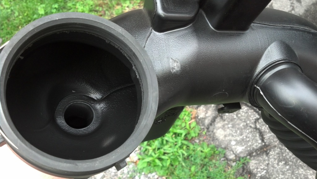

When you put the 90mm TB on do you have to buy a bigger intake tube or does your stock tube still fit?

Stock tube still fits. However, the stock tube has a ton of restrictions; if you're going to put a bigger throttle body in, you really should replace the factory intake tube.
The stock air tube will not work. It does not have clearence for the TB motor. You will need to have a aftermarket air tube like a mit or cai
you can see here were the tube hits the tb motor. both throttle bodys are the same size were the tube fits so you will have no problem mounting a MIT or CAI with the new TB.

Oh, wow, I didn't know there was interference with the TB motor, I just knew both throttle bodies had the same OD. Regardless, an MIT is a good idea if you're looking for more flow anyway.
