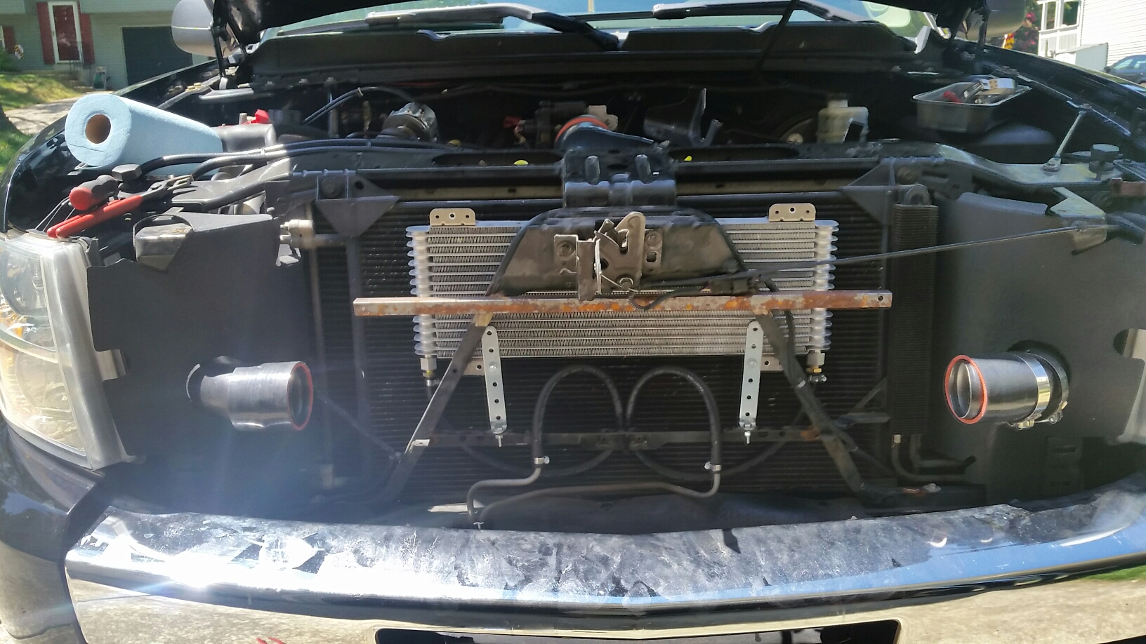

So I installed the Trucool 40k unit today and installed as shown in the pics. I had read about many people who say orientation doesn't matter and the air will purge out just like in the stock external cooler that's also oriented with fittings downwards .. what's everyone's thoughts on this? I left plenty of tubing so I could flip it in case the general concensus was to do so ... thanks!

looks fine mine was mounted the same way with a intercooler in front of it. I never seen over 150* with a circle d 3600 stall and 6l80

trans cooler looks great. now grind down that piece of square tubing and get some krylon on it.

Drove her around today. Temps never went over about 170

170F?! Thats pretty hot. Mine never went over 130 with a high stall and 100F ambient temps on the road.

I highly suggest getting rid of those hose clamps on rubber hose onto smooth metal line. That's asking for a line to come off, ive seen it many times.
And no doubt someone will say " No it wont Ive don't it that way just fine" People tend to say that till they are sitting on side of the road with a cooked trans.
just flare the ends of the metal a little. that's what I do.
