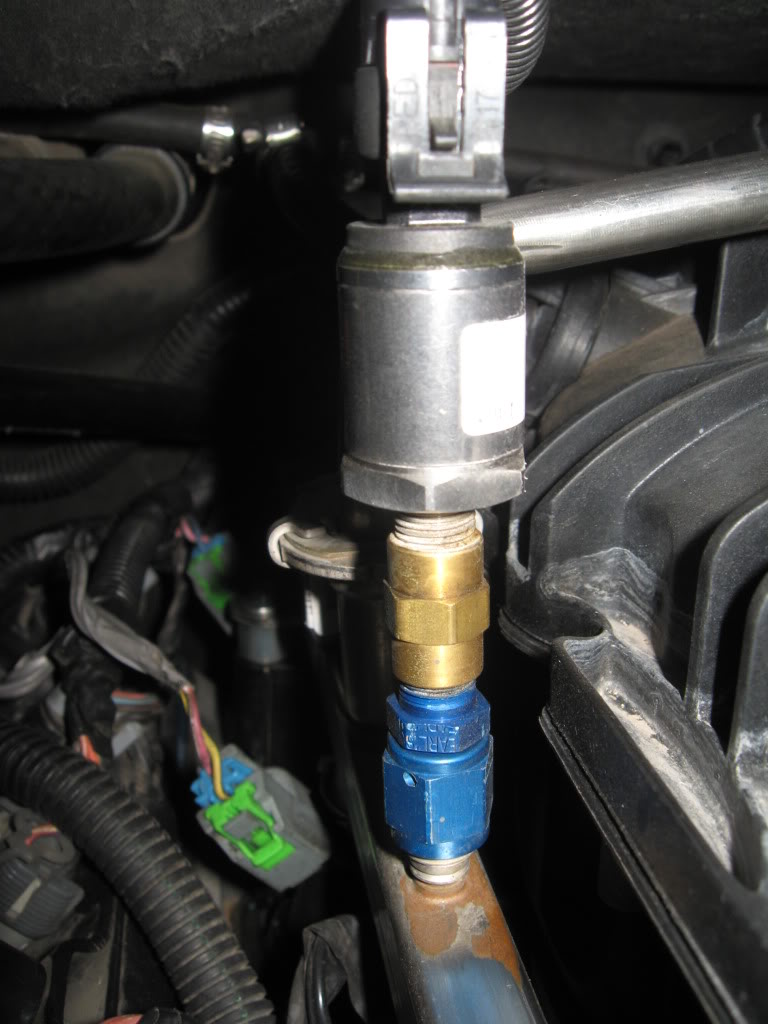

Hey this might be a dumb Question but here it goes....
I just bought a fuel pressure gauge for my NNBS. the kit comes with a 1/8" pressure sender...where exactly am i suppose to connect this to?? do i need some type of adapter to install it on the schrader valve on the passanger side fuel rail?? i want to get the best accurate reading possible....thanks

i think we need autometer #3227 tubing and line kit to be able to connect to the schrader valve but no sure....anybody?????

hey do you know if the port on the fuel rail is 4AN??

I guess that EARL'S fitting don't come with the gauge from automater , does it? Any part # ? thanks

yea its a 4an if im not mistaking...i got mine set up almost the same way
no it didn't
did you have to remove the the small valve inside the port?

Yep... remove that valve...I did mine the exact same way!!!!
