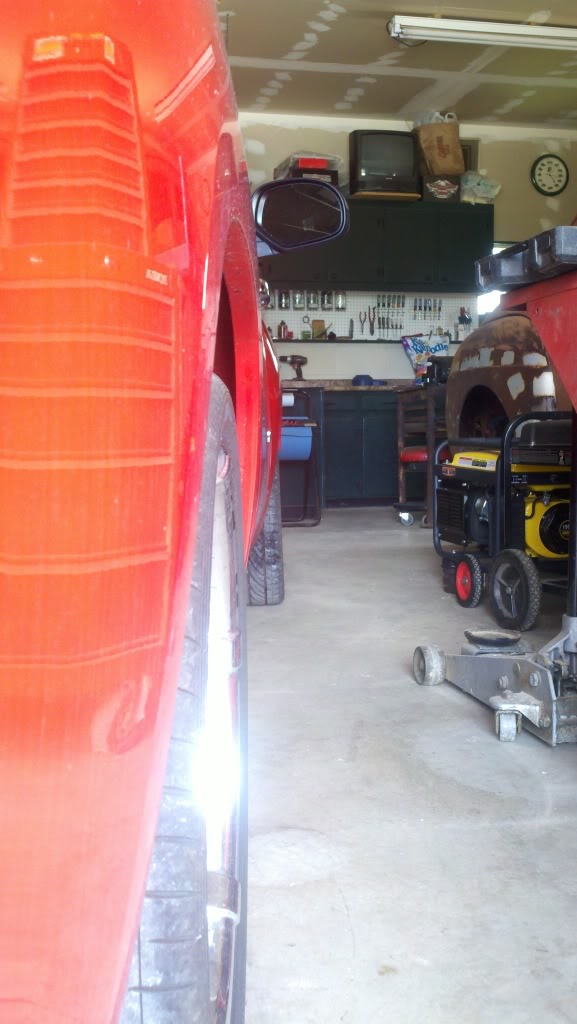

Pics as requested. The bolts i used are 7/16-14 grade 8 Just a fuzz bigger than the factory 10mm bolts. if you do this DO NOT use the factory tin nuts. buy real hex nuts if you want to reuse the bolts. used flat washers on both ends with a lock washer behind the nut

KC, this is the best i was able to do with the camber on the front. i dont daily drive this truck so im too worried. finally got time to pull the trans out and do my stall/servo/shift kit

Interesting.... at least I know that there is another option out there to lower it some more. How much drop did just flipping these get you? Hell this would work with stock struts even.
