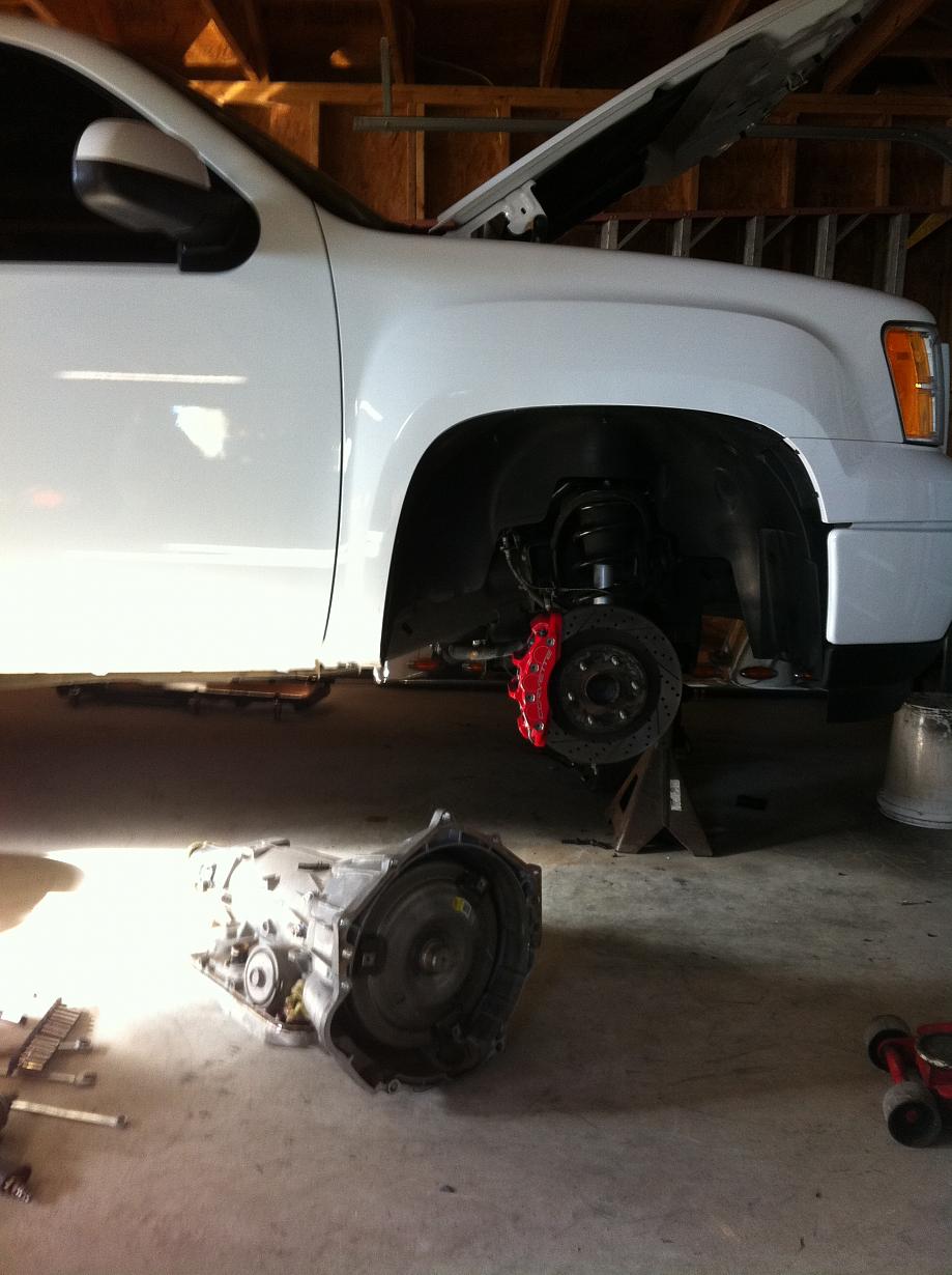

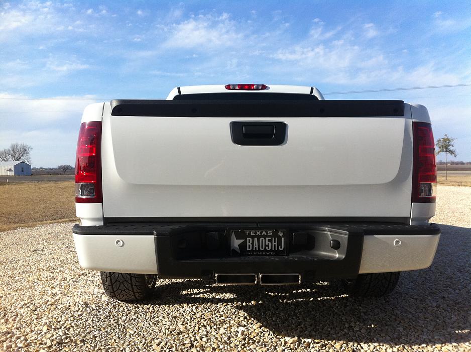

Well the engine work is done and I'm very happy with the results.
TSP 220 Cam, Longtube and ORY, Circle D 3000, LS2 intake and Dyno tune
The power came in at 336hp and 330 tq. This is with 12.5 air/fuel and unlocked converter, so there is probably more in it but I left it on the conservative side. I didn't build it for the track so there is no need to run it on the edge.
