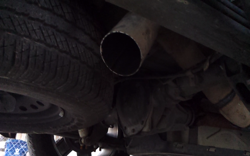

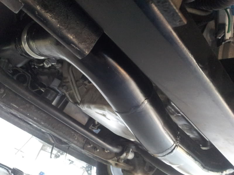

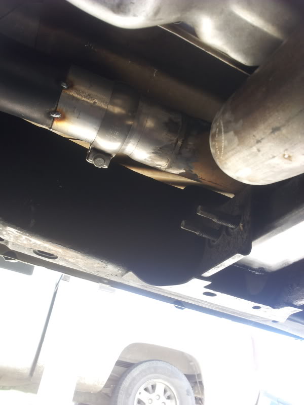

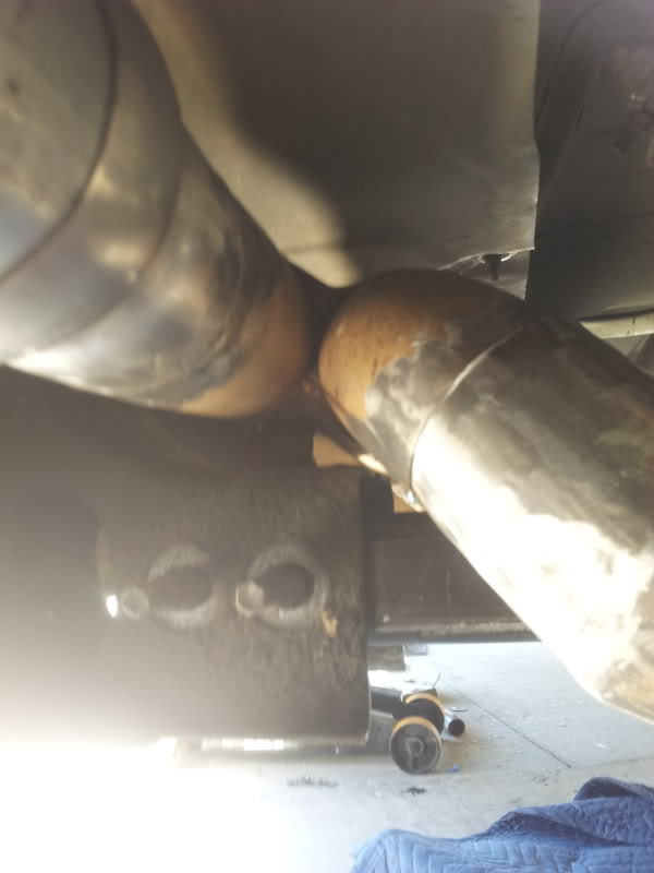

This is the only picture i have of my duramax exhaust on my crew cab. I had to offset the muffler a tad to line up with the oem exhaust. Then chop the axle section to make it clear.
I can get more pictures tomorrow if needed.
As for the muffler it wont be much louder, but it will be a tame setup for boost later

Can u snap a pick of the y pipe connection and then your muffler mounting

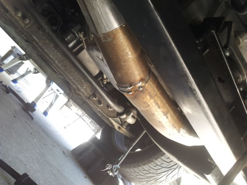

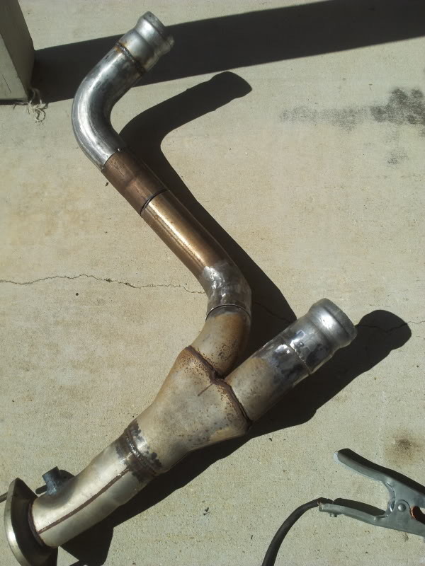

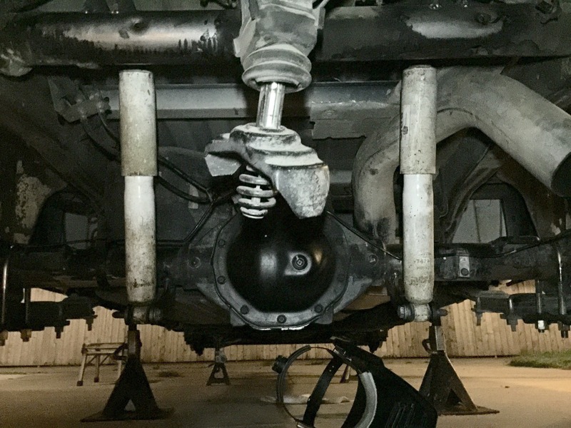

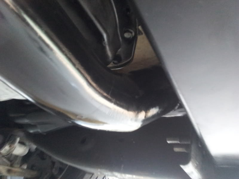

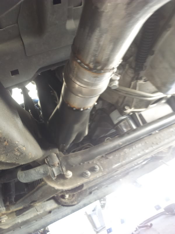

I custom made my y pipe. Its a 3" into a 4" merge from summit.
Ill find what pics i can on photobucket.
Old Jan 11, 2016 | 10:55 PM
iamkeniff's Avatar
Posts: 5,365
From: Gonzales, la

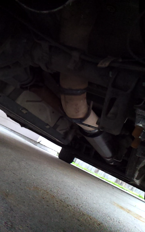

It's got a stock duramax muffler on it now
