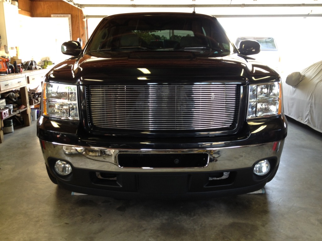

Like this?

HD bumper or whole front end like mine? To put just the bumper correctly you have to drill and remount the tabs to line up with the 1500 upper cap. Now to put the whole front end is just as easy just need to cut and reweld the bumper mount brackets and align the bumper correctly so everything fits right.
