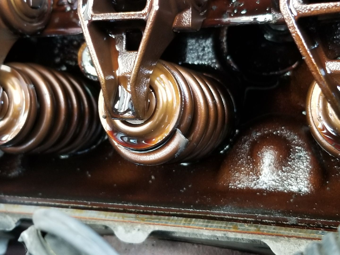

Originally Posted by 95wannabe
Will definitely look into that first! Thank you!
This was on a neighbors truck. Nearly 200K on the clock when it let go causing a misfire. Bone stock truck. Swapped the broken spring for one from a set of heads that were sent out for porting.
