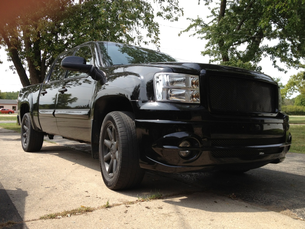

Well u guys we right looks much better now, I can see why the gmc are alil more work but to me it was pretty simple...was gonna try the oven trick like I've used in the past but the lens is much much thinner so I can see it melting down pretty easy...just go out to yours and push in on it in the center and u will be shocked how thin it is
Anyways turned out good I likey

How did you do it then?

Basicly the same way others are doing it. I knew I should have takin pics lol owell il just have to do another set for someone. I think it really came down to the tools I used a dremel muiltmax saw to cut them and separate them then a a smaller dremel stylus with a small bit to cut the tabs on the reflector. Then 3m black weatherstrip adhesive and put them back together. The muiltmax dremel was the best tool I ever bought I swear I could get everywhere with out having to get a knife and a torch out. I think it took me about an hour to do them
