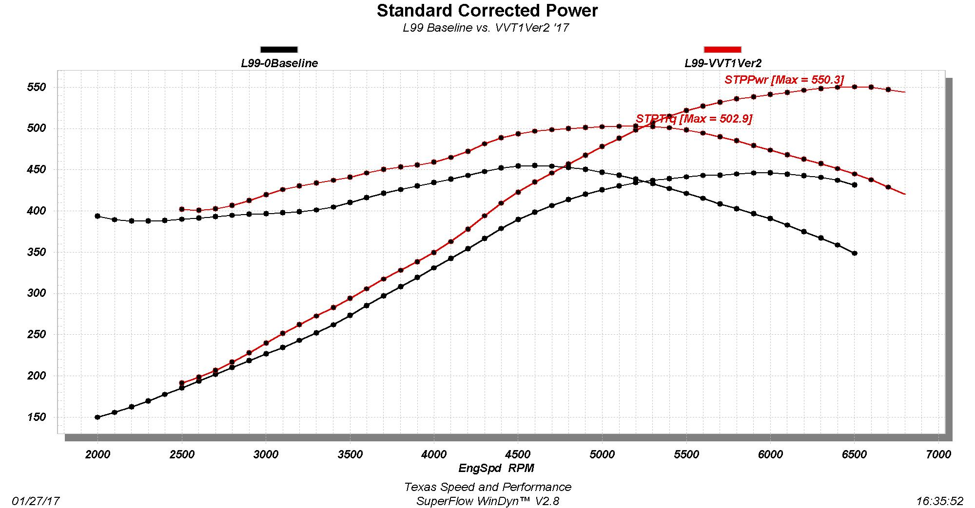

Any thoughts on the TSP 1.2 VVT cam? I know of one L92 Truck owner with this cam and long tubes that regularly tows. He likes it.
https://www.texas-speed.com/p-5769-n...-camshaft.aspx
