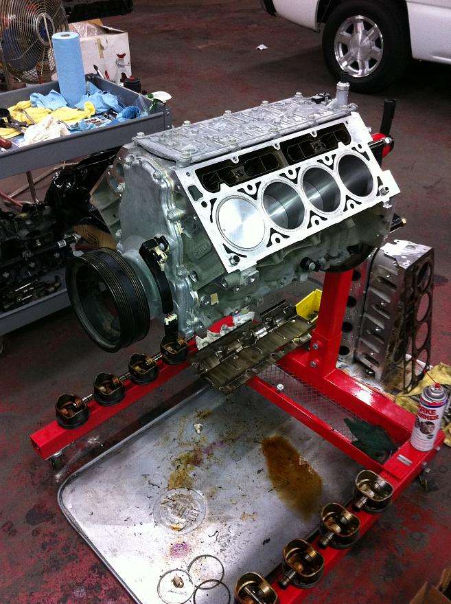

I've fixed a few AFM 5.3L's for the dealership and it's the oil rings are stuck and carboned up along with excessive ring wear. I have been changing the piston's rings, and honing the cyl's. It has fixed the problem for now but I'm sure it will be back. That AFM is a shitty deal I would get rid of it asap. I just did one this last week here is the piston out of a 90K MI 2007.5 AFM I just pulled apart. Heads are nasty too...

Dam that don't look good for only 90k. After seeing those pics I don't think the valve cover replacement will do the job on my 5.3 6.2l here we come lol I wish.
