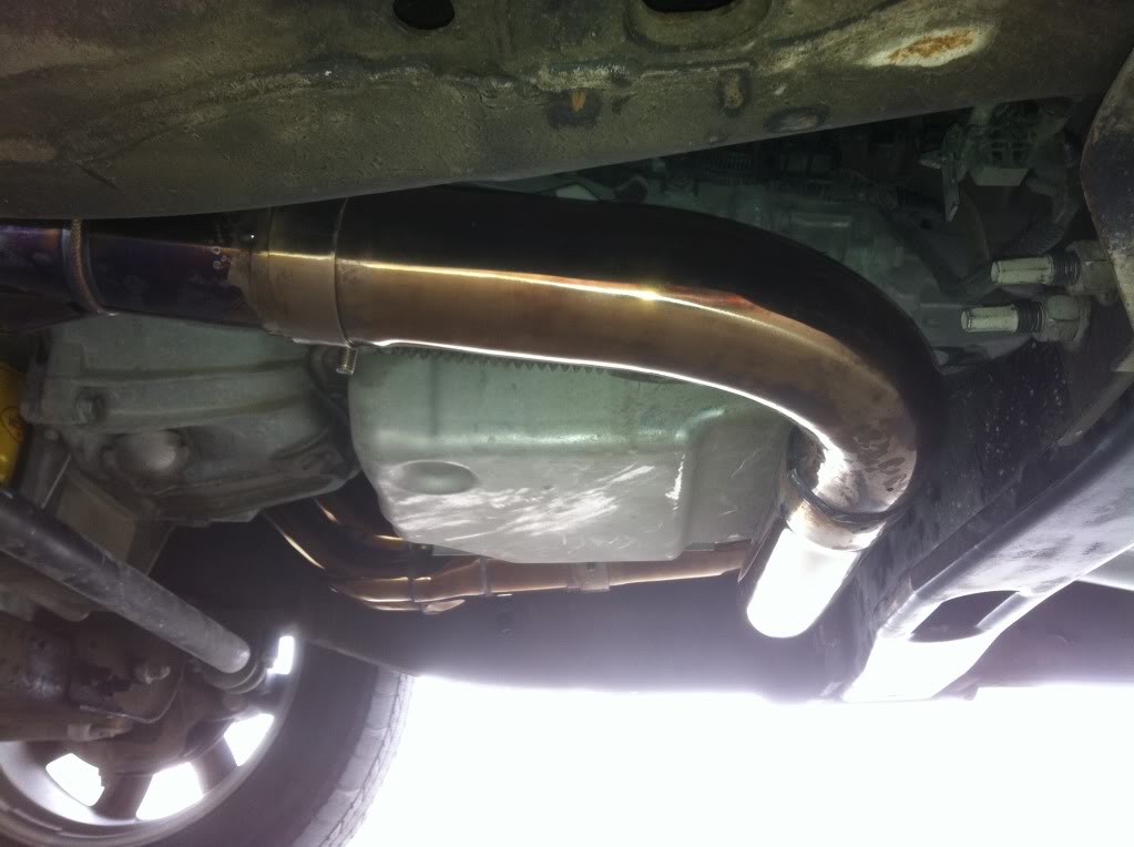

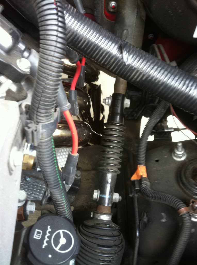

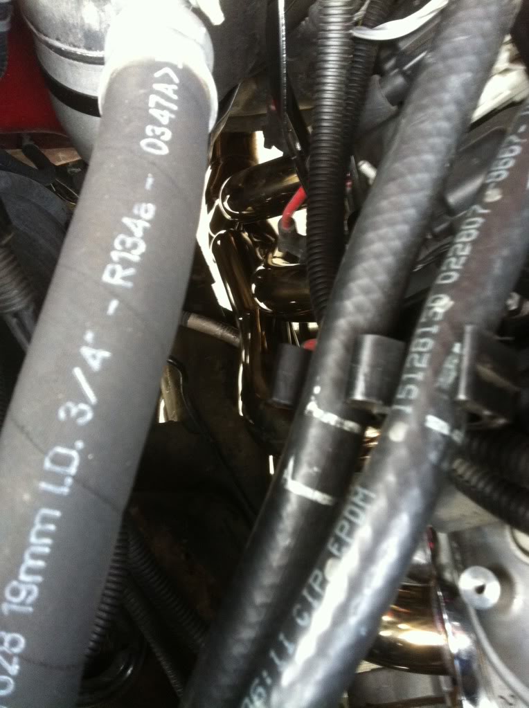

I put the 99-07 classic LPP Longtubes on my 07+ truck the week after christmas. I did it by myself with a 3/8" ratchet and a 1/2" torque wrench lol. It took about 5 hours by myself doing that and texting at the same time.
Install Ease - 5 Stars
Fit & Finish - 5 Stars
Value - 100x Stars
I've installed, ARH, Kooks, Stainless works, Ebay headers and now LPP now on various different vehicles and these fit just as good as the $1500 headers and I only paid $450 shipped (got in on group buy for christmas special). They're normally $500 shipped.
That being said, the one thing I dont like about them, is the coating. I wish I could have got them with a raw stainless finish rather than the polished stainless finish. At any rate, they fit awesome and didn't have any fitment issues. I put them both in from the top down.
