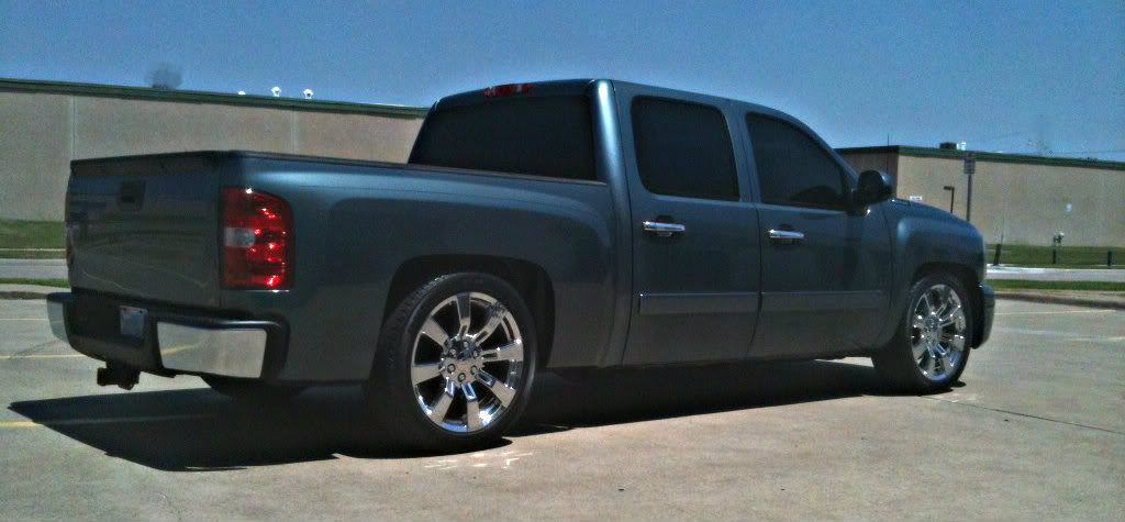

My old truck 4/6 mcgaughys kit(with coil relocators from Tim)

01pewterws6..... are those rims the 22x9? with the 4/6 did u have any problems with them rubbing when turning or anything?

what size tire where you running with that drop and that size rim

^^^that truck is perfect , SICK !

Nailed it!

Yep, GM ck375s(22x9)
Those tires were too big, still 285/45/22s that came with them when I traded wheels. 285/40 or something similar would have been a little better.
Shoot for an overall height of 31" or smaller if you can for less rubbing.
